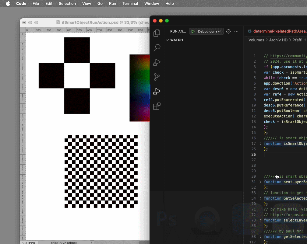

This would run the Action »Action 22« from »Set 1« if the selected Layer is a Smart Object, then selects the next Layer below.
You would need to amend the names and the Action itself.

The script works perfectly! However, I am unable to get it to work as a loop without the error message 😕😕
In light of your feedback regarding the lack of examples etc, I have created a new post (to avoid the Ai request confusing other future people with the desire to loop an action) and added an example set, the action and scripts in there. See This post
