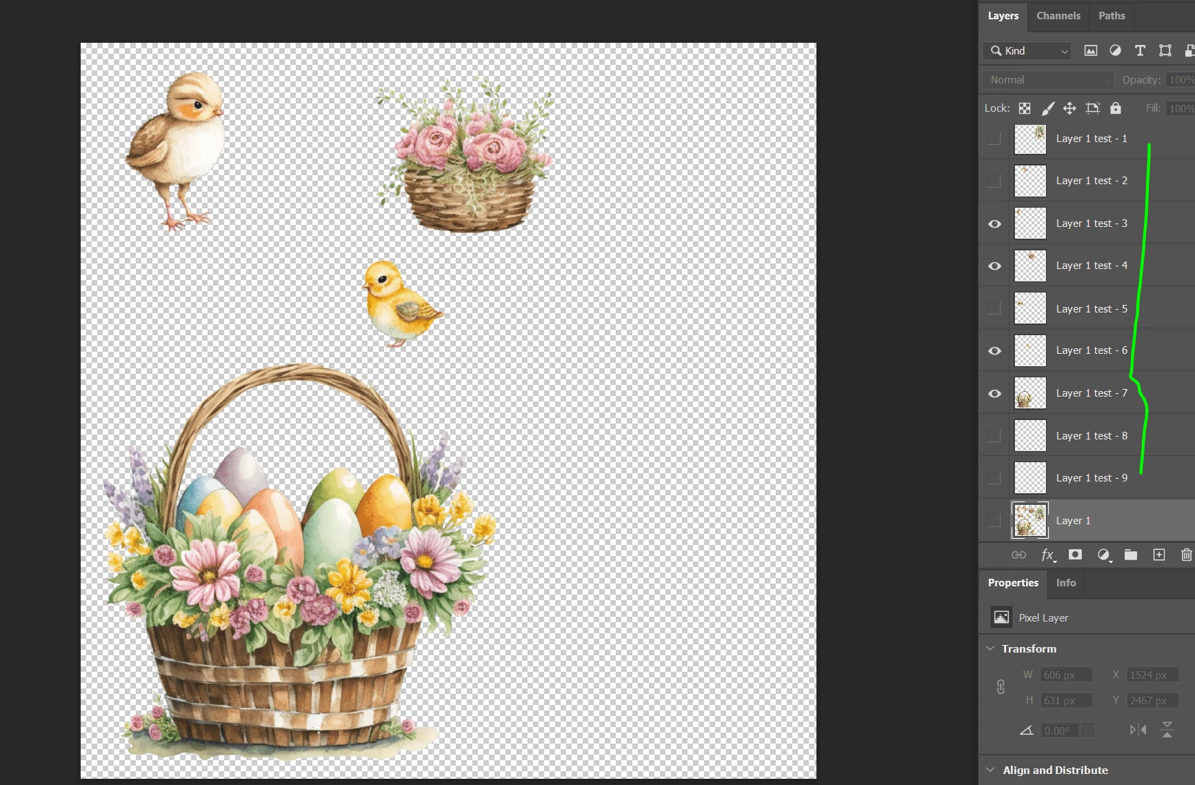

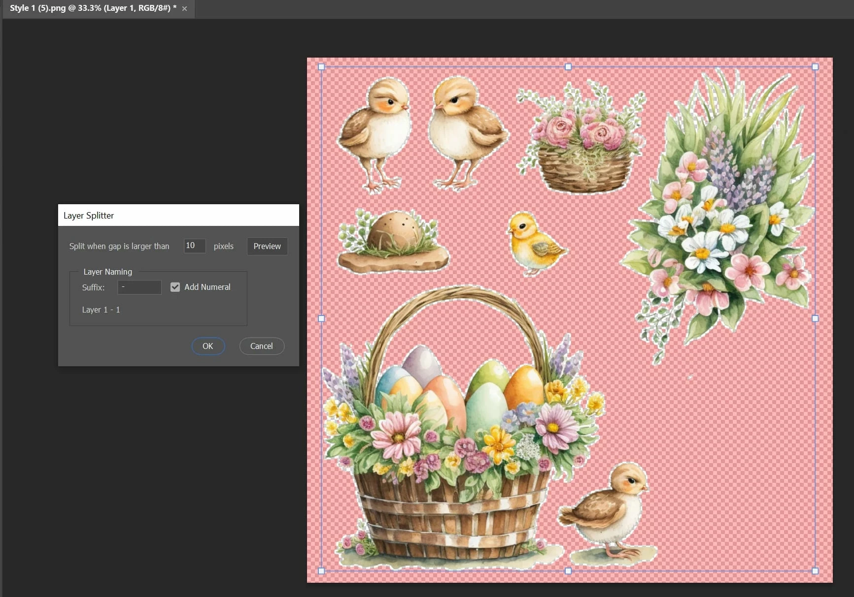

Hello.
I discovered a script that works amazingly for what I need but... I need to automate it so I do not have to open each file individually and then export each layer as PNG (any other option reduces DPI of the original image in metadata).
https://photoshopscripts.wordpress.com/2012/12/09/split-to-layers/
So if anyone can assist, how to set up this action:
RUN Action
 a) it asks for input folder where all transparent PNG images are
b) it asks for pixel range or keeps the default at 10
c) it asks for the output folder
And then export each contiguous group of pixels to its own PNG file, keeping the same DPI (300).
Basically, just automate this script so it performs what it performs on multiple files without additional user interaction.
Thank you.

A little late, however, if it helps anyone – the following code has had the GUI commented out/disabled:
//  photoshopscripts.wordpress.com
// http://www.ps-bridge-scripts.talktalk.net/
//       Split to Layers 1.0      //
//       2012, David Jensen       //
//         With help from         //
//   pfaffenbichler and xbytor    //
//        at ps-scripts.com       //
#target photoshop
//Change any of the following 5 values to customize the default options for the script:
var showOptionsDialog = true; //Set to false to disable prompt to user.
var tolerance = 0;            // the largest gap of transparent pixels that will be ignored. Also sets default
var confirmThreshold = 20;    // If the script is going to make a large number of layers, prompt user to confirm that this is OK
var suffix = " - ";           // Add this to the Layer name of new Layers.  Set to "" for no additions.
var addCount = true;          // Add a numeral to the end of each new Layer
var layerNamePreview=activeDocument.activeLayer.name + suffix;

function createDialog(){
    var dlg = new Window('dialog', 'Layer Splitter');
    dlg.alignChildren ='left';
    dlg.gap = dlg.add('group')
    dlg.gap.orientation= 'row';
    dlg.gap.txt=dlg.gap.add('statictext', undefined,'Split when gap is larger than');
    dlg.gap.input=dlg.gap.add('edittext', undefined,tolerance);
        dlg.gap.input.preferredSize = [20,20];
    dlg.gap.txt2=dlg.gap.add('statictext', undefined,'pixels');
    dlg.gap.btnPreview= dlg.gap.add('button', undefined,'Preview');
        dlg.gap.btnPreview.preferredSize = [55,20]
    dlg.naming = dlg.add('panel',undefined,'Layer Naming')
    dlg.naming.alignChildren ='left';
        dlg.naming.suffix = dlg.naming.add('group')
        dlg.naming.suffix.orientation= 'row';
        dlg.naming.suffix.txt=dlg.naming.suffix.add('statictext', undefined,'Suffix:');
        dlg.naming.suffix.input=dlg.naming.suffix.add('edittext', undefined,suffix);
            dlg.naming.suffix.input.preferredSize = [60,20];
        dlg.naming.suffix.chkbox = dlg.naming.suffix.add('checkbox', undefined, 'Add Numeral')
            dlg.naming.suffix.chkbox.value=addCount;
        dlg.naming.txtPreview = dlg.naming.add('statictext', undefined, layerNamePreview)
            dlg.naming.txtPreview.preferredSize = [200,20];
    dlg.btnPnl= dlg.add('group');
    dlg.btnPnl.alignment ='right';
    dlg.btnPnl.okBtn = dlg.btnPnl.add('button', undefined, 'OK', {name:'ok'});
        dlg.btnPnl.okBtn.active=true;
    dlg.btnPnl.cancelBtn = dlg.btnPnl.add('button', undefined, 'Cancel', {name:'cancel'});
    dlg.naming.suffix.input.onChanging= function(){
        layerNamePreview=activeDocument.activeLayer.name + dlg.naming.suffix.input.text
        if (dlg.naming.suffix.chkbox.value === true){
            layerNamePreview += "1"
        dlg.naming.txtPreview.text =layerNamePreview
    dlg.naming.suffix.chkbox.onClick = function(){
        dlg.naming.txtPreview.text = layerNamePreview;
    dlg.gap.input.onChanging = function() {
        if (parseInt(dlg.gap.input.text) == 1){
            dlg.gap.txt2.text = 'pixel'
        }else{
            dlg.gap.txt2.text = 'pixels'
        tolerance = parseInt (dlg.gap.input.text)
    dlg.gap.btnPreview.onClick = function() {
        makePreviewSelection()
    x=dlg.show();
    suffix = dlg.naming.suffix.input.text
    addCount=dlg.naming.suffix.chkbox.value
    return x;
