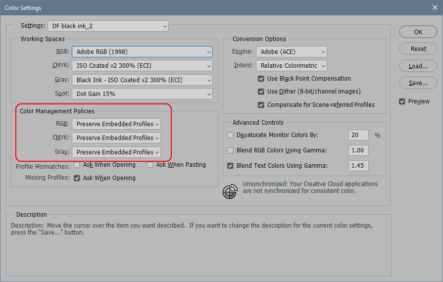

First of all, your first screenshot shows you have turned color management off. Don't ever do that! It's a recipe for disaster.
Policies should always be set to preserve embedded profiles:
(This should IMO have been hardwired like it is in Lightroom, and the other options permanently removed. They cause nothing but damage and confusion.)
It seems difficult to even imagine a scenario in which it would make sense to disregard embedded profiles; maybe if one could be absolutely certain all images are of the Working Space anyway and size is a true concern?

That's odd because when I go back into photoshop & look at my settings, all of the "Preserve Embedded Profiles" are turned on, not off. I don't know what made I was in or how that happened when I took that screen shot but it's not like that now. Unless the template I was using or something had that preselected.
