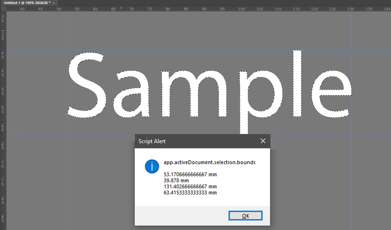

To get the center of a Type object you need to determine the boundaries of each text object - in principle, if we are talking about hundreds of images, not thousands - this can be done manually (in batch cycle with action). Convert PNG to a format with layers, create a new layer with a solid fill over the text - then use the borders of this layer as a container for text (app.activeDocument.activeLayer.bounds)
If the text is contrasting and can be easily separated from the background with selection tools, you can use the bounds of the resulting selection as the container coordinates for the text object (app.activeDocument.selection.bounds).

Thank you! I ended up writing a script that did this. It worked pretty well for many of the simpler images. It requires some manual operation when dealing with complex images that not only contain text, but also icons and other shapes. For those I had to manually select the part that contains the text. But for simple images it works like a charm!
FineFlanAuthor
January 23, 2020
Also, in case anyone's wondering, or having similar problems, what I ended up doing was like this: (Most of these steps can be automated using Action with a few scripts thrown in)
1. Magic wand select a background pixel (like pixel (3,3)) and invert selection.
(Optional for complex images) Intersect-select the part that contains text. Before you start, divide images into different folders based on their layout. Simple images that only contain text (or text in a rectangle with fancy borders) can be completely automated. Images with similar layout can also be automated (for example, if the text is all underneath an icon or something. I can use a script to intersect-select the bottom 20% (or bottom 30 px, etc.) of the image height to get the text selection).
2. Use the bounds of the resulting selection as the container coordinates for the text object. Crop image to selection and export as png to a folder for optimal OCR results. Undo last action,  Layer via cut, rename new layer "text" (or something consistent, for easier automation). Save as .psd file.
3. Use OCR software (I used Tesseract OCR combined with Windows Powershell to loop through all images in a folder) to turn the png you exported in Step 2 into .txt files of the same name.
4. Write script that gets the activeDocument name and looks for a txt file with the same name in the same folder, copy txt file content to a newly created text layer. Resize text layer according to the width of the layer named "text" in the psd file. Position it like the "text" layer. Create rectangle (positioned like the "text" layer) filled with solid color taken from a color sampler taken at a background pixel. Save and export.
