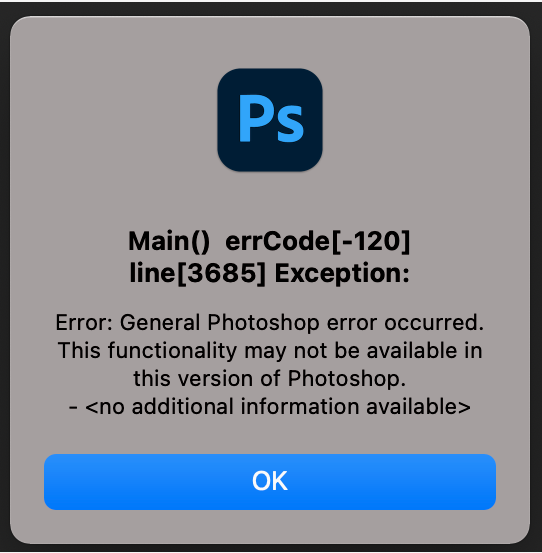

I tried many times and I still have an error.
Here is the short video of what's happening: 30 September, 2021 - Loom Recording

Did you try using the help button and read the help?
The first Script message it telling you. That you did not read the help. The you failed to put your collection of replacement object files for your mockup template's top smart object layer in sub folder obj1 in your Image collection folder that is on desktop desktop folder "pets designs". Your Template does not seem to have an Picture Frame on the wall.And your replacements images have different Aspect ratios and the have white boarders. They will not edited perfectly into a Mockup Template Smart Object Image Layer's Object that have a different Aspect Ratio. My batch mockup sct does not have a Content Aware scale option for that would distort your image's content. If you use the Fit Image option the Edit option while the image wll be fitted to the object there will be additional boarder space. If the Fit image option is not used the Image will be resize the fill the object the Object canvas size will clip the resized image your image will look like centered Aspect Ratio crop. You will loose some Image content. There is no magic. Your Replacement object should have the same Aspect Ratio as the Smart Object that are in the mockup template. You need to understand how Photoshop can resize an images. There is no magic. I do not like to distort image. I will only do constrained resizing so the image will not distort.
You video was of a Display screen on a Apple computer where you have Photoshop open and there is layered template in Photoshop and you are moving the cursor around in the image windows and then around the layers palette there is no audio all I see is cursor movement nothing seem to be done by you. You just seem to be moving the cursor movement. I'll admit I did not watch the video to the end.
Edit: I see now I did no click the play icon what I saw was just your animatef gif. Your Mockup Templater should have a pictire Frame on the wall amd youe replacement imags should have the Aspect ration of the image area of of that frame. The Smart Object image layer you add to the template should be sized and position to the frames image area. You Also need to create the obj1 folder amd put your replacment object file in it. Or you can use the "BatchReplaceOneObject.jsx" and leave your replacment objects in "pet designs"
The second message is a script error message.
Some script you ran failed in its line 3685. That a big script. My script "BatchMockupTemplates.jsx" is much smaller then that it only has 821 line of code. The script most likely fails becaus the was somethig missing ih the document you were processing. The not available usually means some document condition the function requires is missing therefore the function is current grayed out it not available. An activa selection maye be required but a selection step may have failed to make a selection.
I have no idea what you last image is
