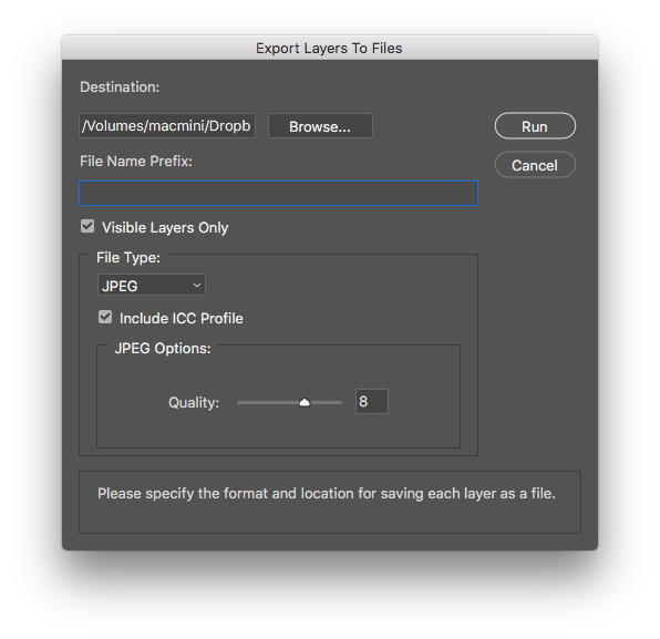

New Here ,
Dec 08, 2017 Dec 08, 2017
When I look for the same in CC version 2017.1.1 I see: does one of these do it?Screen Shot 2017-12-08 at 12.20.08 PM.png
New Here ,
nm, found it in export layers to files!! yay

For me I'm using Photoshop version 21.0.2 (windows 10). Go to file --> export --> layers to files and select the folder & type you want to save.
