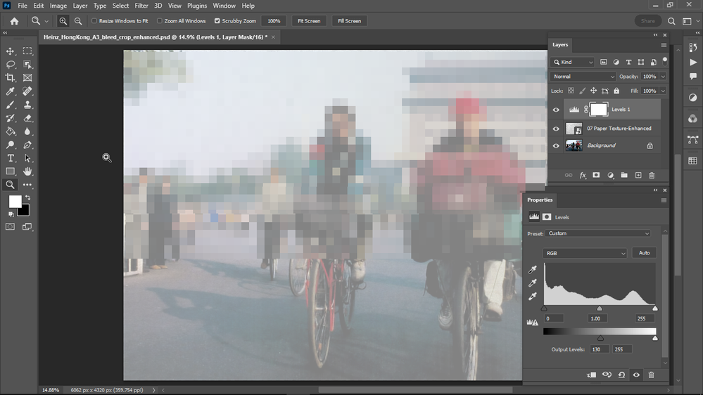

I'd use Multiply, but you will probably need to lighten it as much as possible without losing texture. For instance a clipped Levels adjustment like this. Layer 1 is the paper in Multiply:

You haven't clipped the adjustment to the texture layer. That prevents it from affecting the image layer.
Look carefully at my screenshot again.

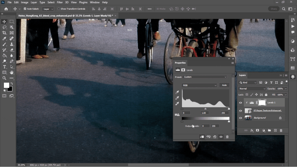

Why is my adjustment layer thumbnail different than yours?
Isn't it necessary to turn the paper texture black and white to make sure the color of the paper texture will not interfer with the colors of the image or the multiply blend mode doesn't allow the colors to blend?
If I push up that slider (that removes shadows, right?) I am loosing my texture.
I can see that you have an embedded paper texture there, and mine is linked, because I have that icon on its thumbnail.
Does that have any significance for this blending?
Jan 02, 2023 Jan 02, 2023
It's just that Multiply builds up density in a cumulative way, so that the final result can easily get a bit too dark, and not quite as it would look in real life (where you would also get some lightening). You want the effect, not the overall darkening. So you lighten it to compensate. Go as far as you want, don't overdo it.
The icon is because wide formats will replace the adjustment icon with a generic one because of limited space in the panel. The icon has fixed width, so height goes down.

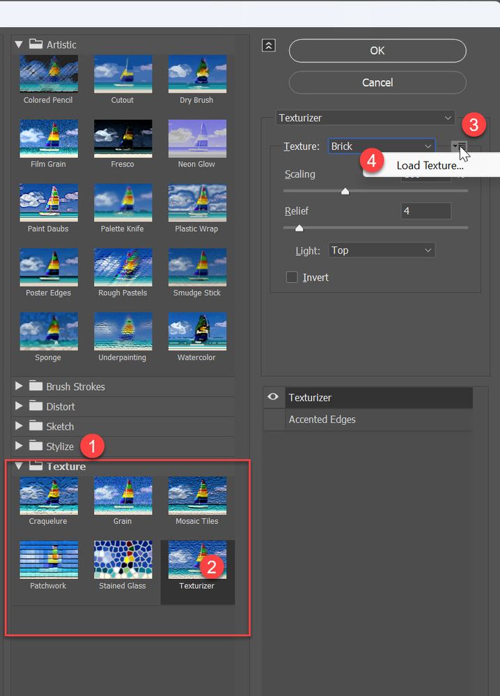

You may want to know for lesser known texture option from Filter > Filter Gallery > Texture > Texturizer click on hamburger icon then click Load Texture and navigate to PSD file with texture.

I tried it, but it doesn't work with my PSD paper texture.
