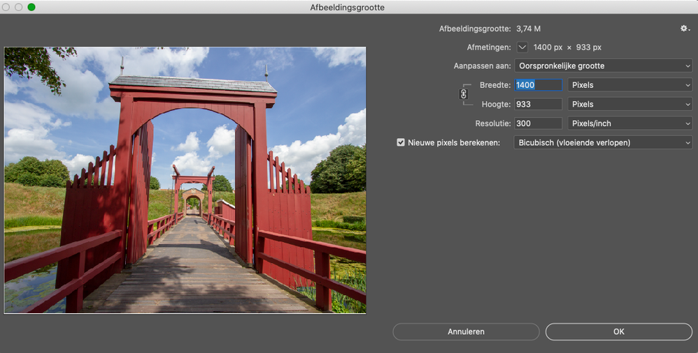

I try to find out the best image size setup(s) in Photoshop 2020.
For now my computer is fill up with RAW pictures and big JPG pictures between 12 and 24 mb each picture.
When I am busy to correct my pictures in Photoshop I will also reduce my picture, so that I have a better overview on my iMac screen. I use also an action with a great special framework around my pictures. So that my collection is finished for screen view.
But I will find also the BEST quality setup dimensions and resolution, so that I have also a good print photo. For now, I was busy to change my pictures all the time with the setup in the example picture below. Is this the correct setup, or can somebody support me to give me better examples? I read a lot of tutorials with this topic, but I can not find examples from users when they will save it for both reasons, printing and viewing on the best way.
Thank you for all your hints and tips (sorry, the screen example is Dutch).

The best print image size setup depends on how large you want to print it. The settings you showed can print only a very small photo at 300 pixels per inch, which you will see if you change the units from Pixels to Inches (or cm):
At 300 ppi, your 1400 x 933 pixel example can print at only 4.667 x 3.11 inches, or 11.85 x 7.9 cm. Is that large enough for your purposes?
If you want to create an A4 print at 300 ppi, the image must have 2480 x 3508 pixels. If you are saving images with fewer pixels than that, an A4 print will be lower than 300 ppi.
