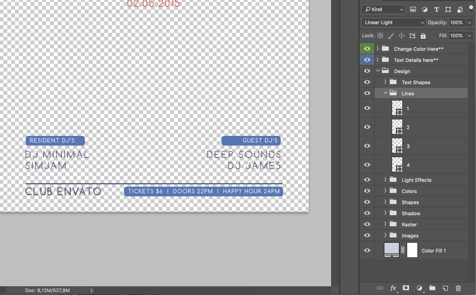

This is an example where the folder "lines" is set to Linear Light.
Only when I change the blending mode to something else it will be displayed properly.
The line shapes inside the "lines" folder are 100% solid color with blending mode set to normal.
I have many more examples where there is a problem with the blending mode.

I found out there is no problem when I create a new PSD file.
There is only a problem when I open an older PSD file and recreate the same folder with linear blending mode.
