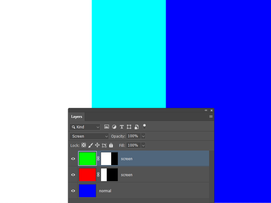

Screen blend mode. That adds the numbers.

RGB(255,0,0) + (255,255,0) results in (255,255,0) with the screen blend mode.

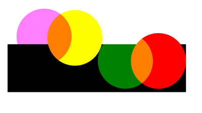

Mixing paint is far different than mixing colors in PS, As mentioned, RGB is additive, while CMY is subtractive. With mixing paint, you are diluting each color with the other color. To get orange with additive RGB, you need to use Red and Green, with green at 50% opacity and with screen mode. Using the subtractive method, you need Yellow and Magenta, with Magenta at 50% on multiply mode.

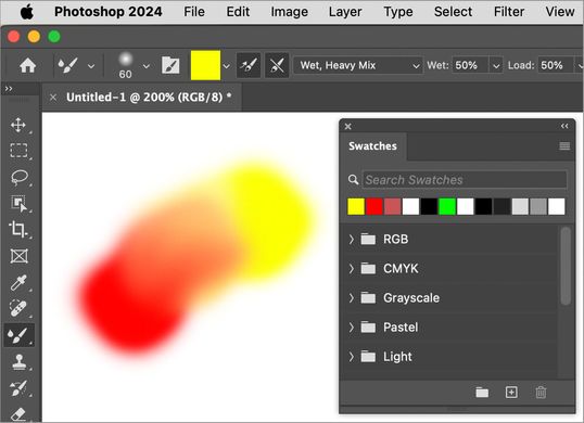

Well, it depends…if someone uses Photoshop for digital painting, the Mixer Brush tool in Wet mode does mix red and yellow into orange, probably because the Mixer Brush tool is supposed to emulate how subtractive paint works. So that can exist in an RGB document where other layers are composited using different color mixing models.
Apr 13, 2024 Apr 13, 2024
I've seen this demonstrated Conrad, but I have not used the mixer brush enough to the get to grips with it, and it has several settings.
