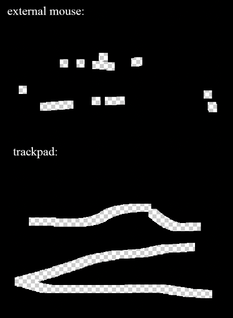

I've found that the mac trackpad is more reliable in this case than an external mouse. No clue why, very frustrating.

To be clear, this is what we're dealing with (on mac):
