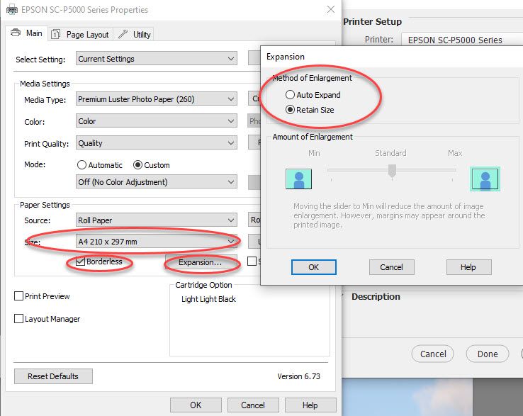

I'm puzzled by your description. If your image size is the same as your paper size, how do you get an "enlarged print", bigger than the paper without it being borderless.
Can you show your print dialogue - both Photoshop and the Epson "Print Settings" dialogue.
In the print dialogue - make sure scaling is set to 100%.
In print settings pay attention to these:

Have you checked the borderless settings in your printer driver, as shown in the post directly above yours? Enlargement on borderless printing is a function of the printer driver not Photoshop and is an option (usually on by default when printing borderless) to prevent white edges due to paper misalignment.
