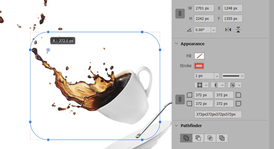

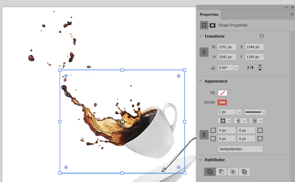

Community Expert , Jan 15, 2023 Jan 15, 2023
@Ken Nielsen
  • Use the Rectangle tool
  • Draw a rectangle
  • Either use the one of the widgets in the corner to resize the corners (circle with dot)
    or
  • Use the Properties panel to type in a number
Note: If the Link button is on (chain link), all controls will be the same. If off, they can be different.
Jane

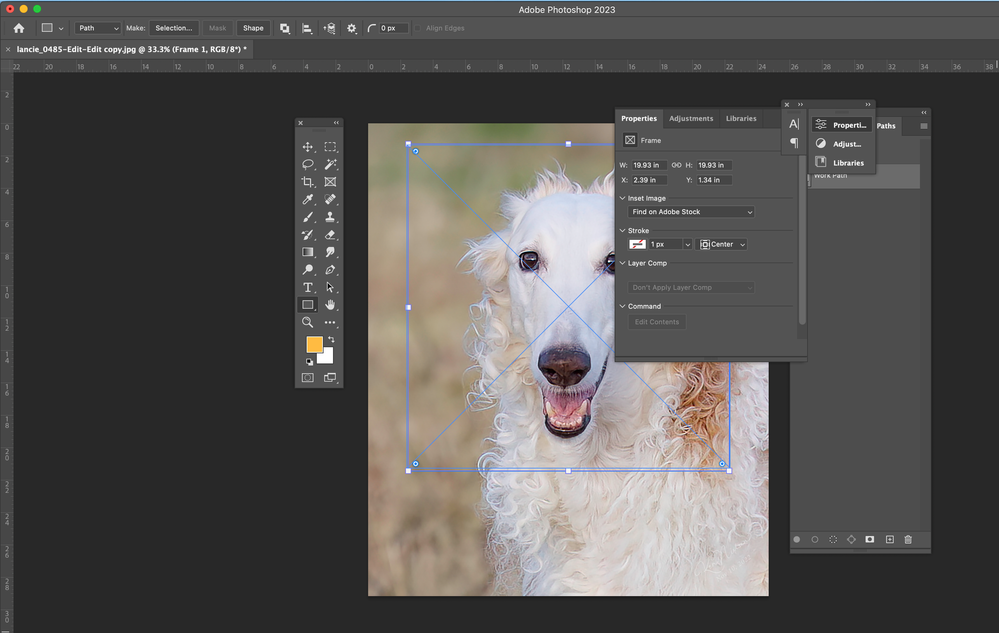

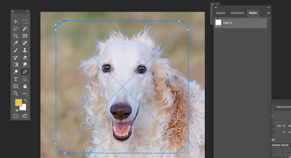

I am confused and need help. The path I made has a square but the rounded-corner shape on the same path seems to not have attachment to the original path, which is all one path. I see that I need to set the rounded corner dimension and THEN draw that path so the Rounded Corners are not something that can be changed dynamically. This whole area I can see is quite valuable, but learning it... I am not quite catching on. Where do I go from here to gain control over making paths like this?

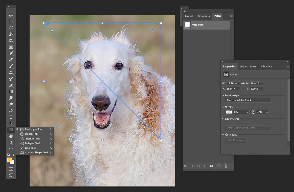

Here's what my screen looks like... the Properties Panel says 'frame' but I guess I really don't care that it doesn't say 'Rectangle' because things are working properly as you say now. Just a bit more practice and then I will comb through this thread again and again as you say Pixxel has given important insight also. Whew, what a day but beneficial thanks to your help.

Just checking…did you intend to create a frame or a rectangle? They are similar but different, and also they are separate tools (Frame tool and Rectangle tool).
The difference with a frame is that it’s a placeholder, like in Adobe InDesign. Use a frame when you want to lay out a page with shapes that you will fill with content later, like with a photo you haven’t decide on yet. If you just need a rectangular path or shape layer, then use the Rectangle tool, not the Frame tool.
One consequence is that the rounded corner options appear only for a shape, not a frame. I don’t know why. But that’s probably why you aren’t seeing the rounded corner options. You can tell it’s a frame because of the big X through it.
If all of this seems new, frames and the Properties panel are both relatively recent additions, and the way rounded corners work was overhauled not too long ago.
Today, when you draw something in Photoshop, you want to be aware of whether you are creating a path, a shape, or a frame, because they work differently.

See how in my example there is an x through the 'Frame' but contrary to what you have said about Paths being the only choice where I can have rounded corners, you can see the little 'dots' in the center of the radius of each of the four corners and moving that dot will change the radius of the corner... the Properties panel says it is a 'Frame' or at least the Frame box is checked in the upper portion of the panel. Please excuse me as I flounder with this concept now. I want to learn.
Jan 16, 2023 Jan 16, 2023
Well, now I’m confused. I’m not sure why I am not getting the corner widgets or Properties controls for rounded corners on frames. Hmm…
