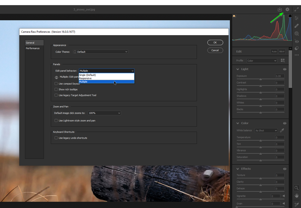

Hi there,
My camera raw (ver. 16.0) is a bit different (attachment). Now everything is put on group, it's too complicated to work with, I just see all of the option I want to adjust in the previous version but now they all gone away.
Is there anyway I can get the previous interface back?
Thanks!

@Justin3020633906eq go into the Camera Raw settings and set the Edit Panels Behavior to Multiple, then expand all the panels, once you open Camera Raw again the panels should remain opened

I would also like to upvote to bring back the possibility of merging those tree panels into one again – as it complicates the workflow how to work with the shortcuts and makes the UI more chaotic. For example before I was able to use the CTRL + 7 to open the Geometry panel, now it's the 10th panel and thus I cannot use the CTRL shortcut for it anymore. I know, that I can re-arrange my panels to match the shortcuts at least a little bit, but this is really stupid. (I know about the "multiple" option as well, but that does not solve everything as I sometimes accidentaly close the panel, it's more chaotic and I liked the "single" mode before, as it made possible to focus more on that one single panel with all the functions I needed at that time and I was able to navigate through the panels quickly)
Some option like merge the panels before or "compatibility" mode would be really nice and would save a lot of people significant amount of frustration and anger when seeing a new "improved" version of the UI...
Thank you.

Ged_TraynorCommunity ExpertCorrect answer
October 13, 2023
October 14, 2023
Thanks @Ged_Traynor, I think your solution is the best to get the closest look with the odd one. I appreciate your help!
