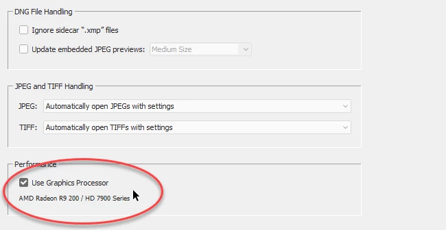

    Hi
    If you open Photoshop and go to Preferences Camera Raw and uncheck Use Graphics Processor can you then open your file? At least this should show whether it is a problem between ACR and your GPU set up or something else.
    Dave

    Hi
    Dave
    March 27, 2017
    Yes, saw this in some of the posts and tried it both in the prefrences for Camera RAW and Photoshop, but makes no difference. Cheers
