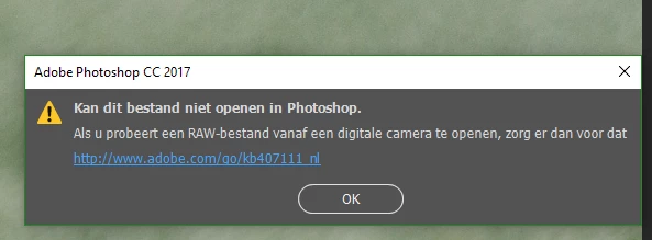

Since about a week I am not able to load pictures made with Canon EOS 80D any more in Photoshop version 2017.1. The camera Raw plugin info states Camera Raw 9.3 is installed, opening a RAW picture from out of LR into PS or directly in PS provides an error stating:
This indicates that Camera Raw is not up to date.

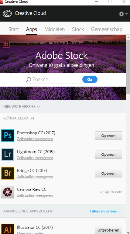

Replacing Camera Raw is not possible with the manual update links either, and the CC menu does not allow any changes either:
In short, Camera Raw does not really plug-in in PS, and I cannot use PS any more.

The Canon 80d requires at least ACR 9.5 why back level to ACR 9.3?

Where do you see 9.3?
There's a confirmed bug in the latest ACR/Lr release that produces this erroneous message. You can ignore it - just click "don't show again" and "open anyway". Things work normally from that point. It will be fixed in the next update.

In PS Help- about plugins -Camera Raw gives:
I now found this 9.3 coupe was resulting from files with the name: Camera Raw.8bi (as was stated in the PS info file).
I have deleted those files, and installed a 10.9 version of CR manually.
Now I am able to open my RAW files from out of LR in PS again.
However, opening the RAW direct in PS is still a problem and PS does not show RS as plugin any more

Yes, Camera Raw.8bi is the name of the ACR plugin.
It has to be installed in the correct folder, so that all the applications using it will find it. I can't recall the exact path, but it's under Common Files. If you install in the PS plugin folder it won't work properly.

If Photoshop menu Help>About Plug-ins is grayed out I believe you have a bad install. Photoshop installs many prug-ins.
The Creative Cloud Desktop application should Install ACR 9.10 and update the Creative Cloud software that uses ACR to use ACR 9.10 except for Photoshop CS6 and Adobe Bridge CS6 they should have ACR 9.1.1 installed by the Creative cloud Desktop application. Lightroom I do not install but I know Lightroom does not use ACR except to to have Photoshop open your RAW files through ACR with the RAW conversion setting you develop in LR Develop module.
