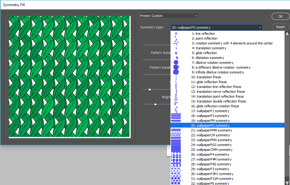

This might get you started.
Make your leaf, and define it as a Pattern.  You need the transparent surround.
Edit > Fill
Set Contents: to Pattern
Select your leaf pattern
Check Script and chose Random Fill from the drop down.
OK that which takes you to this panel.  Density makes a lot of difference.  Color Randomness messes it up IMHO.
There are some other interesting fill scripts, and if you use the drop down, you might be overwhelmed with choice!

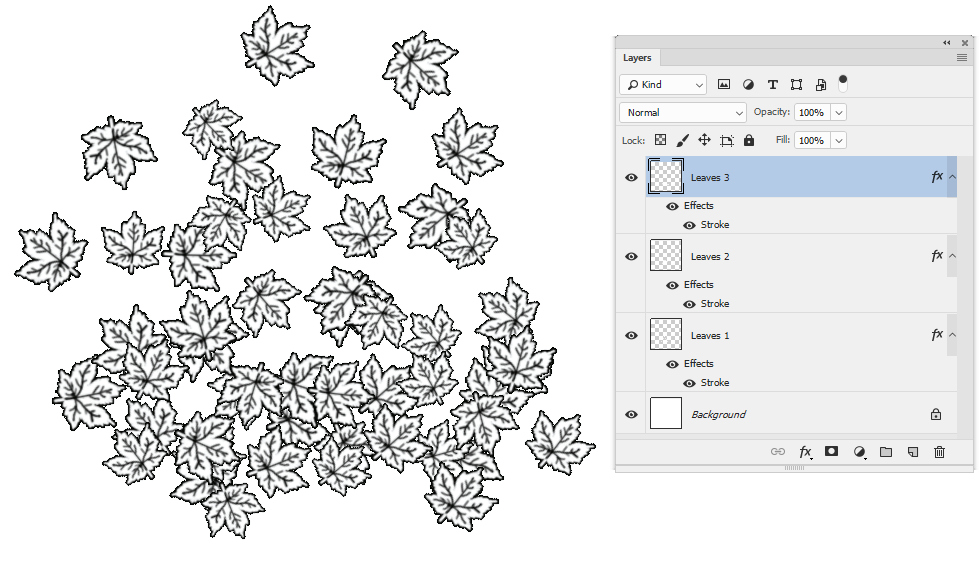

Then set an empty layer and set layer styles to give a black stroke on the outside
Then paint on the layer with the brush set to white. That way you are only painting the solid centres - the layer style will add the black strokes. Don't allow the leaves to overlap on that layer
You can build up additional layers with the same layer style to get the effect of overlapping leaves
I hope that helps
Dave
