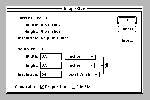

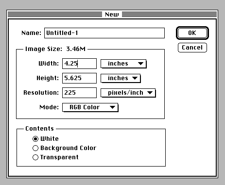

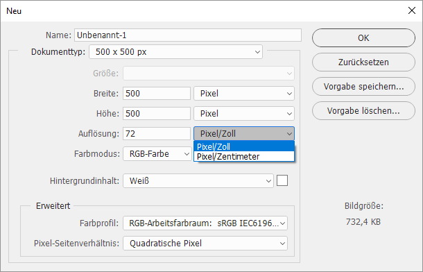

mbdesigner schrieb
… that in the updated version of Photoshop that I have (cc 2017) the settings are all now for ppi not dpi …
Can you show us a screenshot, please?
There is no version (that I know) in which you can set dpi in file new dialog.
eg PS 6.0
or PS CS2
or now in PS CC
Copy link to clipboard
Copied
PS 1.0
