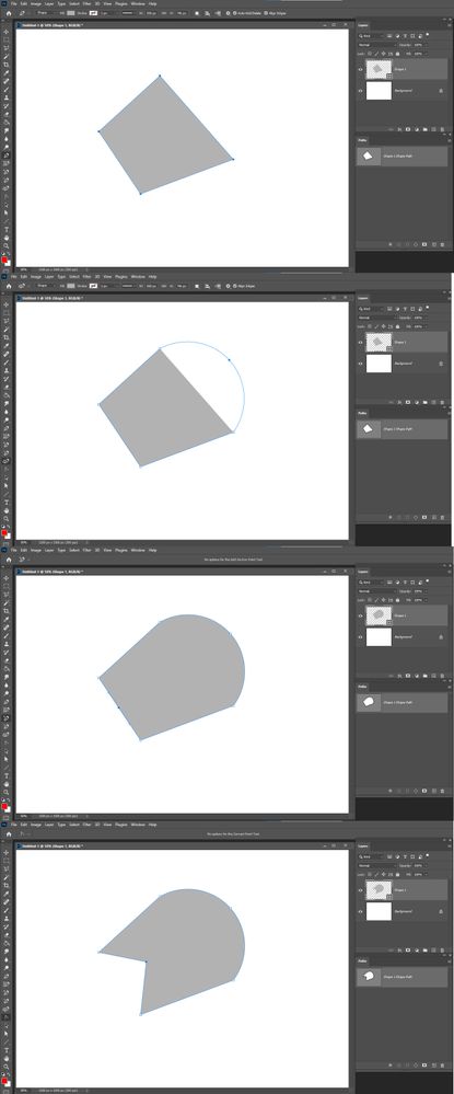

You edit the path of a shape  layer with Photoshop vector tools.  No matter how the shape layer was created. Here I have a shape layer I created with the Pen tool. I just create a shape layer  by laying out a closet path using four control points. You can see the Shape's Path the blue line overlay.   I switch to the curvature Pen tool and edit a top line segment.  I then switched to the  Pen +  point add tool and added a control point to a bottom line segment.  Switched to the direct select tool and  moved the control point I just added.  Switching to the Convert Path point I removed the curves moving the control point created.  Etc, etc, etc...

You can not set the Pen tool to a mask mode just to Path, Shape, and Pixel mode. However, when you set it to Shape mode what it actually does is  create a Fill layer  with a Vector Layer mask. The mask is not  shown  the Layers Palette.  Just a shape layer icon is added to the shape layers Content Thumbnail bottom right corner in the layer Palette. When a shape layer is the current Photoshop target layer you can see the vector Layer mask in the Paths palette and the path should outline the shape in the Image displayed. So the Shape layer only property in the Properties Palette is the Vector Layer mask.  You can change the Layer's Fill in the Pen Tool Tool Option bar  Shape Fill option  Empty, Solid Color, Gradient, or Patter. You can add a normal Layer mask and target the normal layer mask an paint on the mask.  There will be two mask in the Properties panel. However you can only change the Fill layer content in the Tool Option Bar. Its not possible to target the fill layer content and paint on it even targeting the shape layer's thumbnail in the layers palette.
