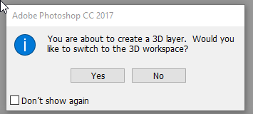

    There are two ways of opening an obj file.
    1. Use File open to open it into a new document. When you do this you get a dialogue (example below) . Are you seeing that dialogue, and is there any chance that it could be hidden behind other applications or on a secondary monitor?
    Next would be a progress bar as the obj document is opened. Depending on how complex the model is that can take a while.
    Eventually you should get The workspace dialogue , followed by a color-space dialogue
    then the model should open
    2. The second way is with a document already open , use menu 3D - New 3D Layer from File. This gives the same dialogues, although sometimes I find that the progress bar does not appear and you just have to wait.
    Do either of the above work for you?
    Is the model complex? I just tried loading the guitarBass model from the Adobe Felix project. The obj file is 137MB  and that took a while to run through the dialogues before the model opened. Simpler shapes loaded very quickly.
    If the above does not help - please give further details of the issue and your system (if you go to Photoshop - Help -System info and click copy - then paste the details into your post it would be helpful).

    Thank you for your response. These step by step instructions are well done and I really appreciate it.
    My problem is the reading OBJ Format bar just disappears and nothing ever seems to come from it. (I walk away and do stuff and return later)
    Original I didn't have the the Open GL on but I fixed that and it just doesn't load anything
    My 3D drop down is greyed out as well so I feel like maybe there is another setting I am missing.
