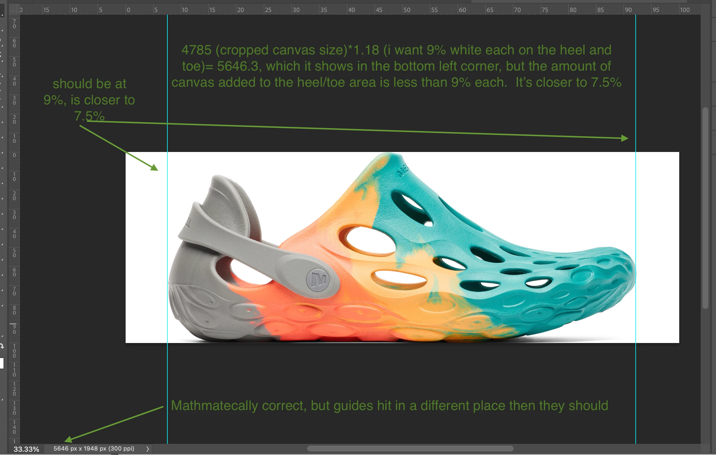

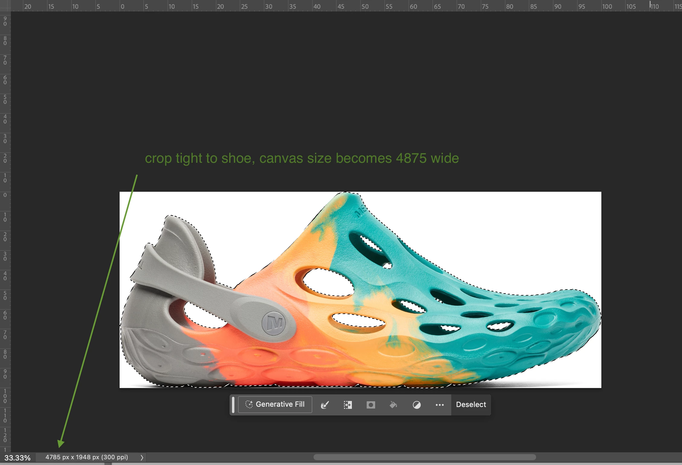

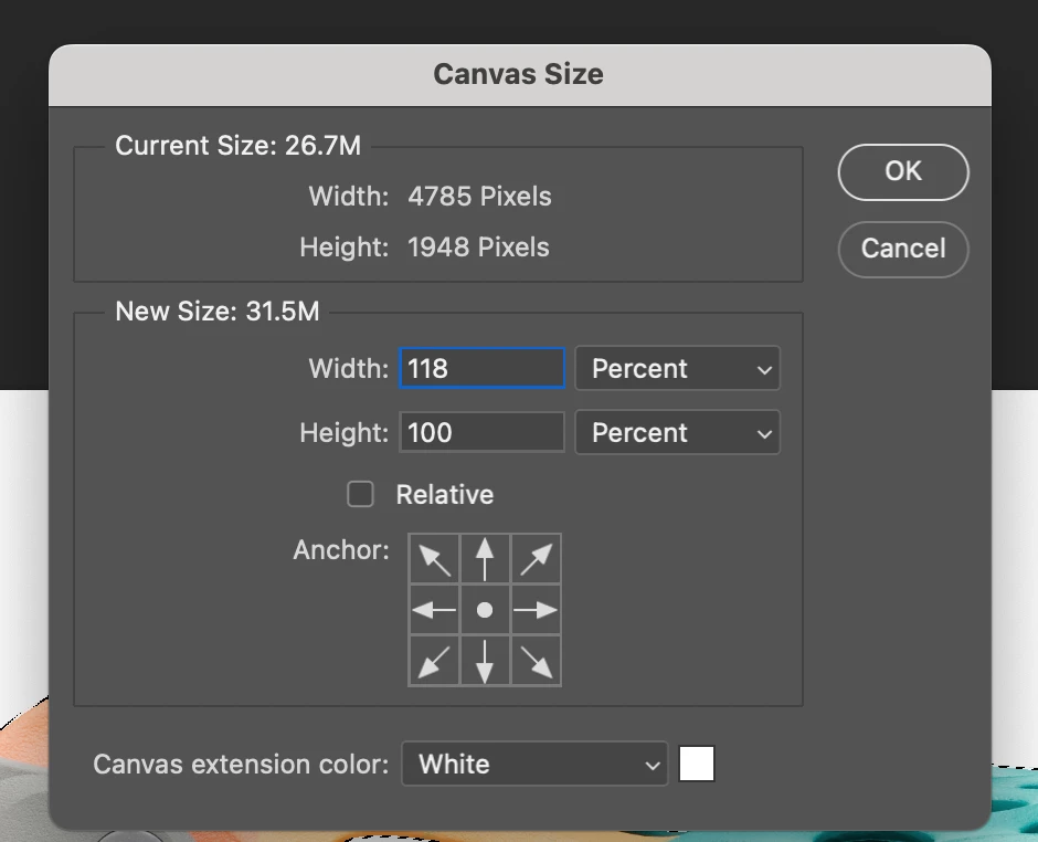

I feel like I'm crazy.  I am cropping tight to a shoe, then expanding 118% so there will be 9% white margin on the heel and shoe.  When i do this, either by canvas width increasing 118% or by checking the relative box and choosing 18%, I get a margin that is closer to 7.6%.  If I do the math and increase it by pixel size instead, the same thing happens.  The canvas size shows that it's correct, but the amount of margin that grows is incorrect.  This happens on PS 24 and 23, chat was no help, fresh install did nothing either.  Someone help me understand how i am doing this incorrectly.

4785 x 1.18 = 5646
Your new canvas width is 5646 pixels wide.
Put that number into Canvas Size. It will add equal amounts on either side.

Maybe a better question is:
How would i use math to get 9% margins on either side of my canvas if i start at 4785.  What would I type in for the canvas width? 9+9= 18, so i would think 118% would give me the result i need.  Since you keep telling me the math is correct, help me see how typing 118% doesn't give me my desired result?  How would YOU get 9% on each of the toe and heel?  I feel insane, but we just keep talking around each other.  I don't want 7.6%, i want 9%.  Thanks

Your maths is incorrect.
4785 x 1.18 = 5646.3 which rounds to 5646 as Photoshop can't add half pixels.
That is 5646 - 4785 = 861 additional pixels
861/2 = 430.5 at left (and 430.5 at right)
The left guide will now be at 430.5 which is 100 x 430.5/5643 = 7.6%
The right guide will be at 100 x (5646-430.5)/5646 = 92.4%
Photoshop is working correctly
Dave
mrshoffuAuthor
January 29, 2024
Hello-  Can you look at my screenshots?  What youre suggesting is exactly what i've done, but the result is not what you'd expect.  I calculated that then added it manually to the left side only, repeated for the right.  But again, my shoe is filling too much of the frame after that expansion.  It's like the shoe layer sizes up?  I ended up experimenting and wrote an action that crops tight to my shoe (4785) then expands the canvas to 6635, a difference of 1850 pixels.  1850/2= 925 pixels.  Doing this puts my guides (at the heel and toe) at 9%, but 4785*.18= 861 pixels. I don't understand why i have to arbitrarily come up with a pixel expansion to get my guides to sit at 9%.  I should be able to use math.

Well, it's easy enough to find out. Note the pixel width before and after, and then open the calculator and multiply original width by 1.18.
