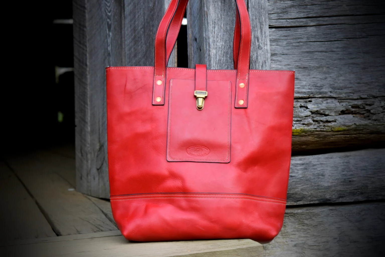

In the studio I'd do this with large soft boxes and possibly a light tent - but outside on an overcast day usually works pretty well. Just be a bit careful and use your eyes, you can still get direct light source reflections. The red bag has a lot of it, and you need to change the angle to get rid of the most of it.

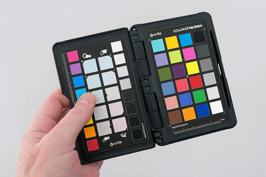

Just to get a baseline for neutral light and exposure, you can use a Colorchecker:

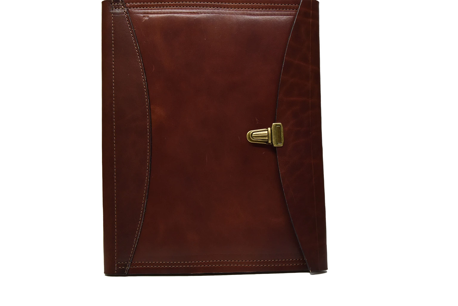

Sure, the first picture shows a Portfolio in a brown and the second in a red.

The challenge here is that the colors are not captured under the same lighting conditions. How would the first color look under the second lighting condition? That's the problem, in my opinion, why simply sampling the color numbers and trying to match them on the second photo won't work. If you capture all the bags in the same studio with the same lighting, then you may be able to match the colors closely. Otherwise, different lighting, setup and even device with different output settings will affect the color accuracy.
I'm not very experienced in this matter, so maybe @D Fosse  can offer more help.

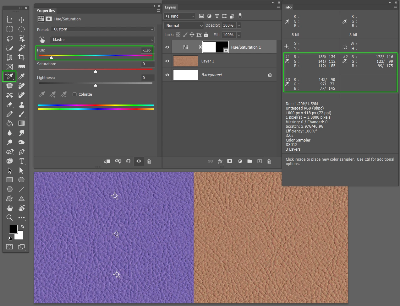

Easiest way would be to use a Hue/Saturation adjustment layer.
I like to add some Color Samplar points, and read the changed value in the Info panel.  If you have a reference for the RGB values for the different colour versions, then you can adjust the sliders to get as close as possible.  My mantra is tha 'the numbers never lie'.
