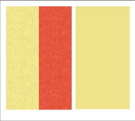

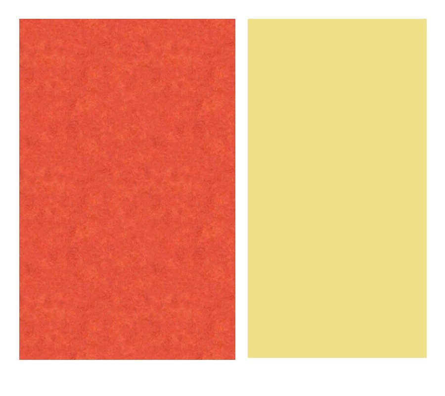

Hello guys,
below, in the left box, you see a simple pattern I regularly use, but always in different colors:
I always have a specific target color I want to need to get as close as possible to. However, changing the color of the pattern is always a drag, I'm not good at it. I usually use the color replacement brush, sample the target color (for example the one in the box on the right), brush over the pattern and then adjust through the color balance options. It takes a lot of time (for me), and the results are usually only acceptable. Are there alternatives?

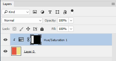

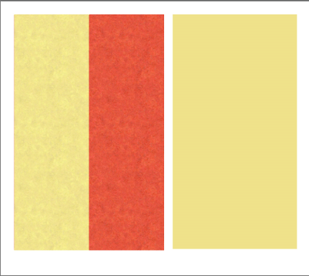

For the change you show above:
1. Set the eye dropper to a reasonable sample e.g. 31x31 - not point.
2. Shift click and place a couple of points on the colour to be changed and a couple on the colour to change to
3. Go into the info panel and set the points to HSB rather than RGB
4. Add a Hue and Saturation adjustment layer and adjust sliders till the points in the info panel match
Dave

Perfect, Dave, that was what I was looking for! Bahaar, thanks a lot for your advice too! Thank you both very much!
