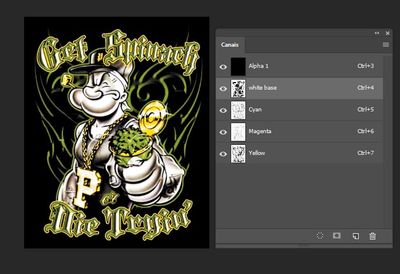

I have this image to print on a T-shirt on a Sublimation printer and I need to change  it to the RBG mode, but when I do that on de menu  Image > Mode - the colors of the image change. How to do it without changing the colors of the image?print.jpg

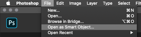

2. File / Open as Smart Object... "Ducky_MultiChannel.psd"

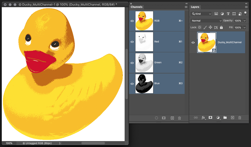

3. Multichannel file are open as RGB file.

Hello, how does the image turn out? You have here an image with a white, Cyan, Magenta and Yellow layers, if I'm not mistaken usually, there is a black layer used to compensate for the ink purity (or lack thereof) and the outlines...

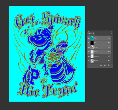

Besides the channels I have a black background on the layers.
That is how the image turns when I change the image mode.Captura de tela 2019-12-04 17.27.30.png
4. Do Flatten Image. OK!

Hello, move the two topmost channels to the bottom of the stack, then convert to RGB, it seems that multichannel assumes that the 3 topmost layers are CYM during the conversion to RGB.

Thanks...It worked. The colors changed a bit because the black and the with base, the two channels moved down stoped working. But I can fix the lost workig on the layers.
