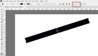

Hi
The stroke value impacts the width of the stroke around the "line" (shown blue below)
The Weight adjusts the line width (values of 50 and 100 shown below)
Dave

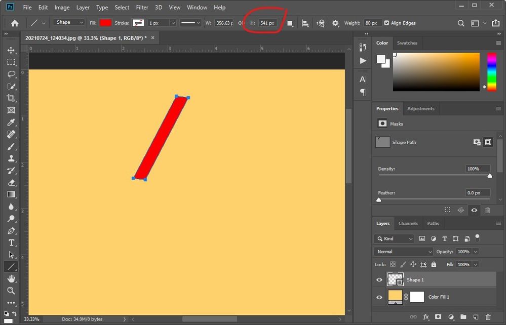

@Semaphoric  -   No, I meant what I said above.
For clarity, this is the current versionj v22.4.3 :
To to make the line, use the line tool to make a shape and set the thickness using weight (here I've made it 60px):
To go back to that shape layer later and readjust the line thickness, adjust the height value (here I've changed it to 30px)
No distortion - just the line thickness has changed
Dave
