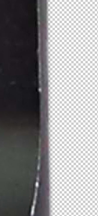

Engaged ,
Feb 14, 2024 Feb 14, 2024
How would you correct blemishes that are on the edge or the edges where there is a transition between 2 surfaces/colours/textures?
Engaged ,
for example
LEGEND ,
I use the healing brush and clone stamp.
