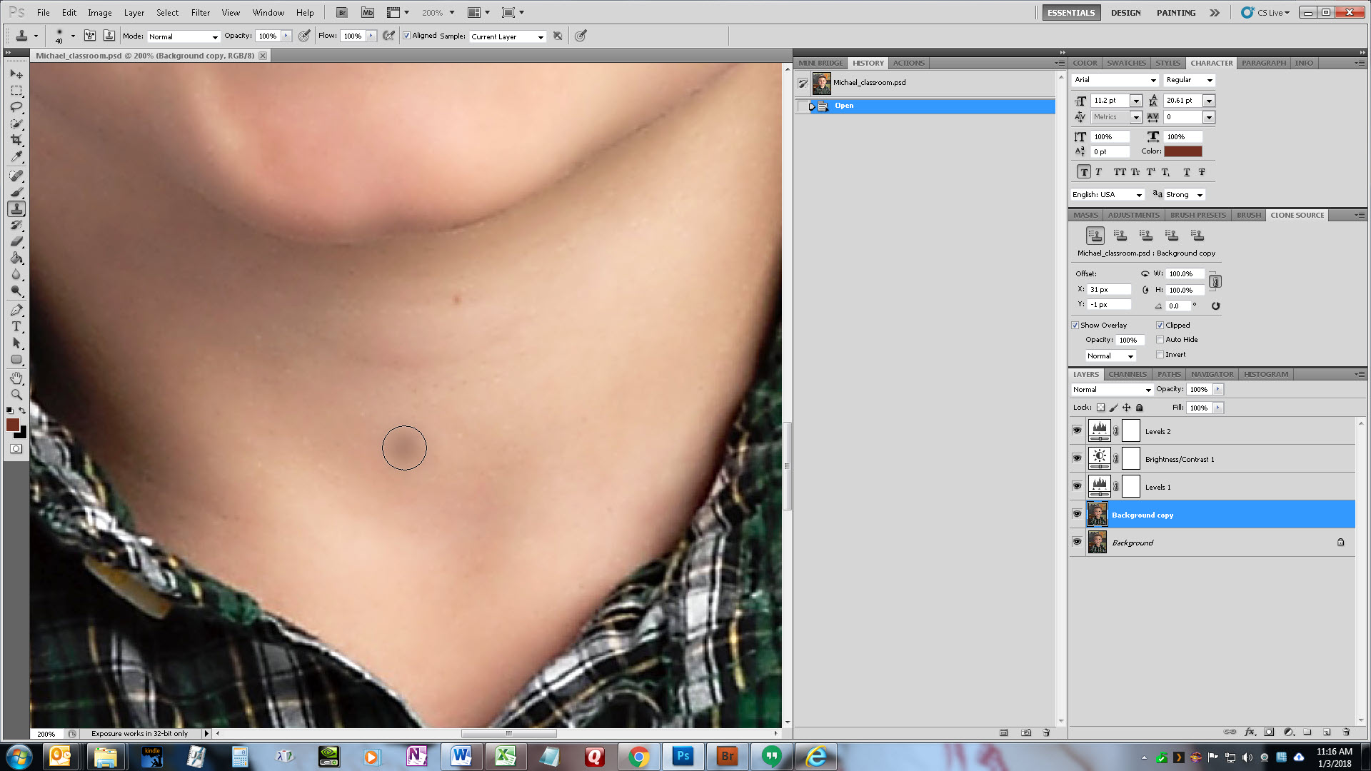

Here's a screenshot of the clone source when using the Current Layer only (source preview is wrong but result is right):
