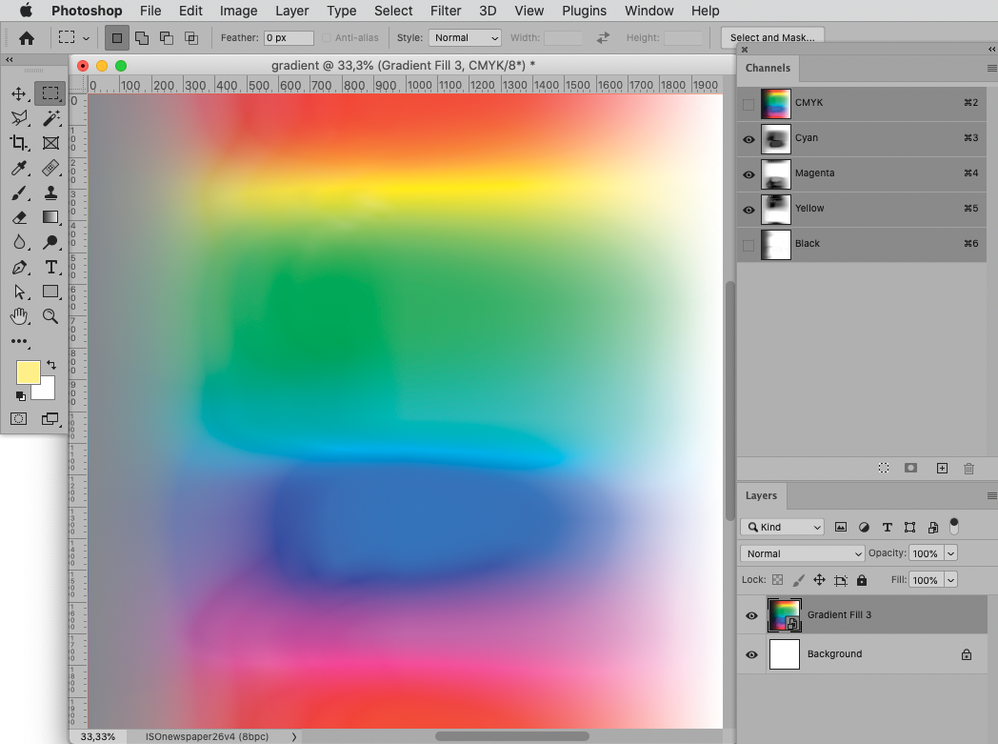

What is the actual goal here?
Depending on a CMYK Space’s GCR/UCR settings the darkest parts may become pretty light without black compared to the full composite, so I am not quite sure what good this would be.
