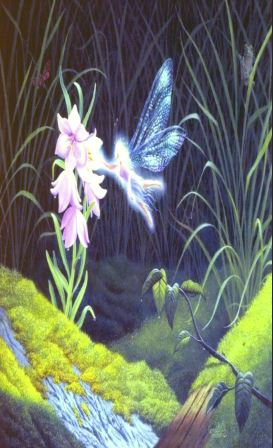

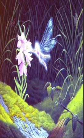

Explorer ,
Mar 13, 2018 Mar 13, 2018
PHAIRY1.JPGphairy2.JPGThe one on the right is photo viewer and the one on the left is from Photoshop. And when printed, it is A LOT worse! (Canon ink loves me!) Thanks

Because only Photoshop does colour management (assuming Windows 10). Chances are all your images show wrong but you’ve adjusted so they look ok. It’s also possible you need to calibrate your monitor.

It's not about one color profile versus another. It's about a color profile versus no color profile. And you don't change document profile in Color Settings. You do it with Convert to Profile. The document profile will override the working space (or it should if you haven't messed up the policies).
But that's just half the picture. The other half of the equation is the monitor profile. In this case it can be one or the other, or both. That's why I asked for a screenshot. That will establish exactly where the problem is here.

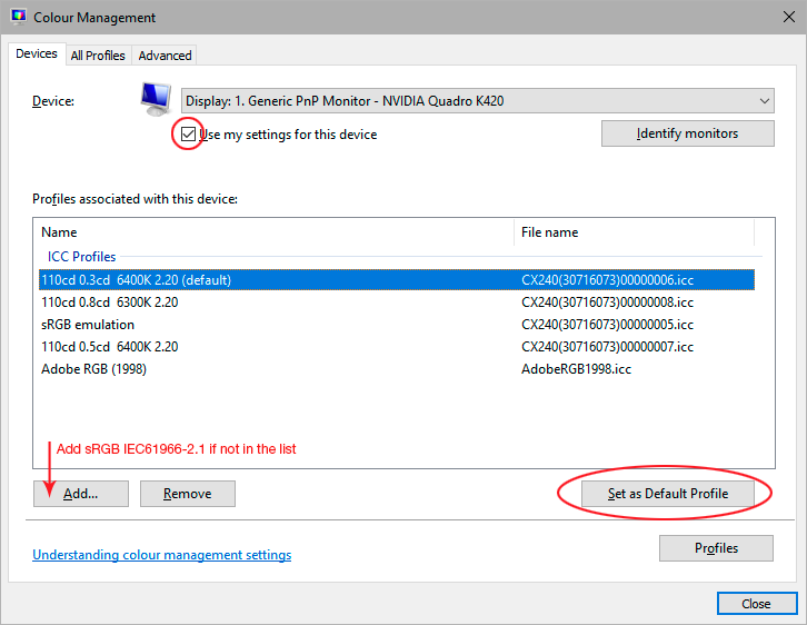

This looks like a broken monitor profile to me.
But first of all, reset all Color Settings to defaults. Just pick one of the "general purpose" presets.
Next, to keep things simple, make sure your document has sRGB embedded. Open "Convert to Profile" and look at source profile. If it's already sRGB, close out. If it's not, convert.
Then replace your current monitor profile with sRGB IEC61966-2.1. That's not entirely accurate, but close enough for most people. It should also ensure consistency with other non-color managed applications (insofar as that's desirable).
Relaunch Photoshop when done, it needs to load the monitor profile at application startup.
If you really want accurate color, you need to buy a calibrator. This will create a custom monitor profile for your specific monitor. Photoshop will use that to correct for the monitor's inaccuracies, and this goes far beyond simple color balance issues.

Don't ever "experiment" with color settings - it will get you nowhere except in deep trouble! Just pick the NA "General Purpose" preset. It will set policies to always preserve embedded profiles, which is what you want.
Also, you need to look at my screenshot again. Go to the Devices tab, not the Advanced tab. Stay away from the Advanced tab altogether. Don't pick the WCS profile, that's for entirely different purposes! It has to be sRGB IEC61966-2.1 specifically.
Don't go overboard - what you want here is in fact default settings all over. No special settings at all. Nothing. Just boring old default, because that works. Even sRGB as monitor profile is the Windows default. Don't ever change any of these settings until you have a clear reason for doing so, and you know what you're doing.
Even if you get a calibrator you don't do anything. The software will set it all up and replace the monitor profile, and that's it.
