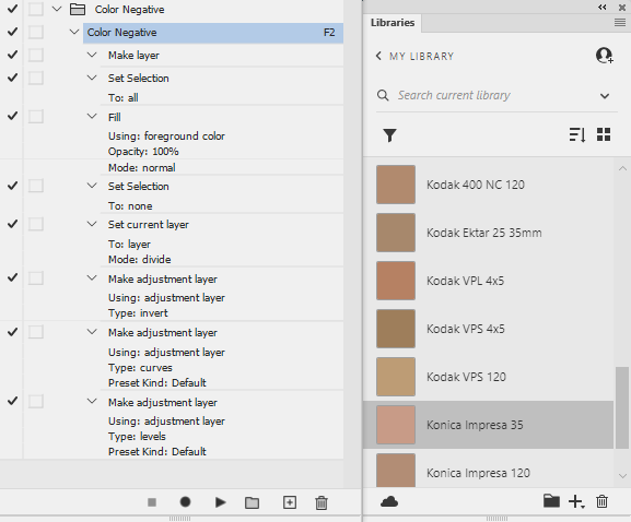

I color correct to what I htought was a good start and attached my work file so you can see my adjustment layers. Hope it helps!
