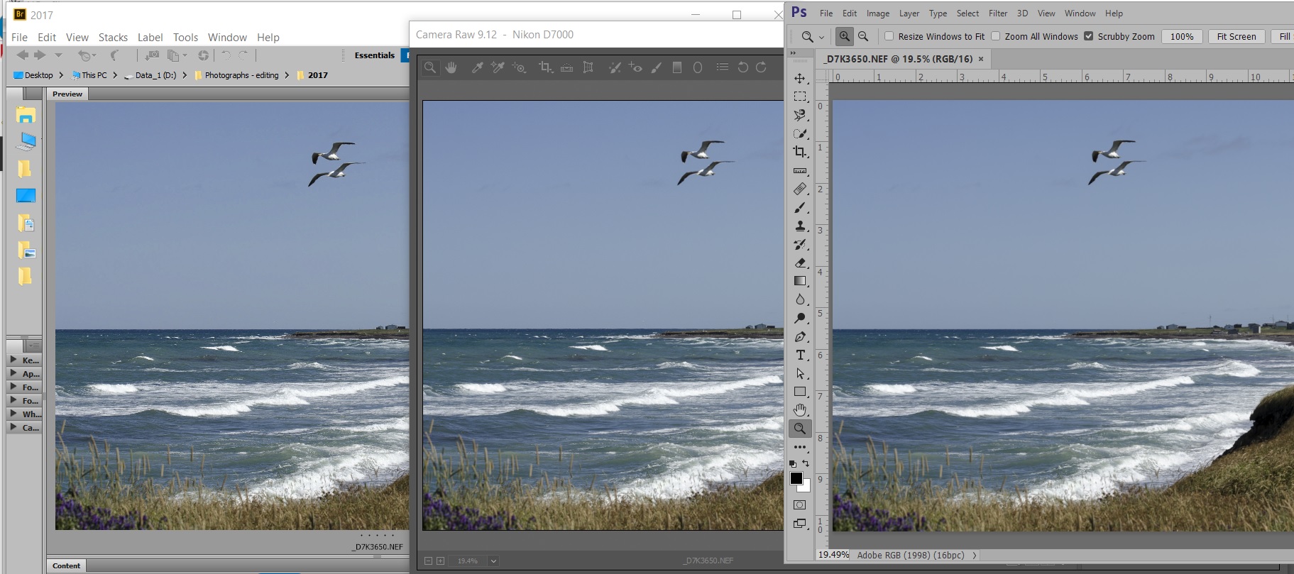

The BENQ was my main monitor. I used the Windows 10 Display Settings to make the DELL the main monitor, and then opened the same image in Br, Ps, and ACR. Here's the result from the DELL monitor ...
Peter
Copy link to clipboard
Copied

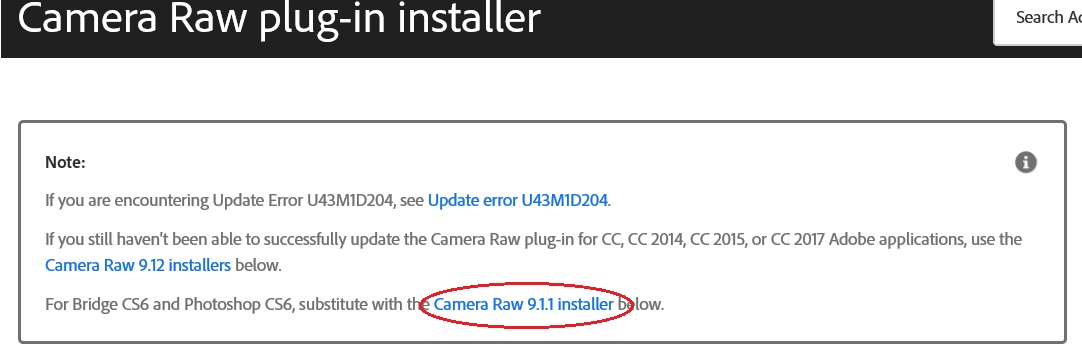

So I did a bit of searching and found (in this forum) a reference to previous versions of ACR, at this location ...
Camera Raw installer for Adobe Photoshop CC and CS6
But I notice this on the webpage ...
Can I safely use the Camera Raw 9.1.1 installer, for CC 2017, even though it doesn't explicitly mention that it is also for CC 2017 ?
If I can't get back to the prior version, then I might just use the ICM profile that was created for the BENQ monitor, on both the BENQ and the DELL monitor. Then I don't care where ACR takes the profile from, and the DELL monitor is not color critical anyway.
Peter

I haven't said anything because the primary<>secondary swap has always worked in the previous threads about this.
I'm also unsure about your screenshots. Judging by the first one, ACR is the odd one out. But the second screenshot actually suggests that ACR was right all the time, and PS/Br were wrong. In that case it could be a general display profile assignment issue with the OS, and the ACR bug corrected it by mistake, as it were.
Bob Hallam mentioned LUT (table-based) profiles. I don't know if that's the default in iProfiler, but if it is there should be a policy setting to change that to matrix-based profiles. That's always considered safer, table-based profiles are known to cause problems in some scenarios. While you're at it, set it to version 2, not version 4.
And just to cover all potential causes, try to uncheck GPU in Camera Raw preferences.

I just redid the swap primary/secondary again, with original profiles assigned as they were, i.e. BENQ profile to BENQ monitor, DELL profile to DELL monitor. I logged off and then back on again. Now Start menu etc. are over on the DELL. I launched Br, Ps, and ACR and dragged them to the BENQ monitor. Here is what it looks like on the BENQ monitor. To me it seems that Br is wrong now.
As a comparison, here a similar shot taken from the BENQ without the primary/secondary swap, but with the BENQ profile assigned to both monitors. To me it seems that all three agree.
And, w.r.t. your comments about LUT etc. (I have the most rudimentary understanding of color management) here is from the i1Profile program. As you can see the default is "Matrix based" and "version 4". And, I have not reprofiled (is that a word) either monitor recently, so the profiles have not changed over the course of this issues appearance.
To me, the best result seems to be when I used the BENQ profile for both monitors. I am going to use that until the next release of ACR comes out. I don't want to run with the DELL as my primary monitor as that messes up a lot of other things, and I think it still leaves Br out of whack.
