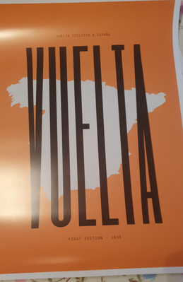

So to cut a long story short. The Pro-1000 is ace. I've just about finished off my first set of inks (pleasantly suprised with how many posters I've done with it) but I have recently stumbled onto a colour issue.

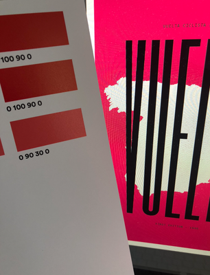

One poster I sell is a light red [Link removed by moderator] and each time I print this colour its coming out orange. The background colour is C0 M75 Y60 K0)
I've tried a colour calibration via the printer which didn't do anything that I could see to the results. And I've now spent a few hours printing out various swatches of red/pink combos and final found one that prints similar to how it looks on screen. However it's bright pink when on screen. (C0 M90 Y30 0k).
It won't render well at all but this is the colour I am using vs the screen colour...
I have the a generic ICC profile for the paper (provided by the paper manufacturer Fototspeed) and its installed / being used by the printer.

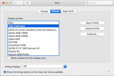

So I am wondering if I need to invest more time in calibrating my screen... I am currently using the built in calibration.
Screen calibration
Any thoughts on things to try out? Happy to invest in a colour calibration tool if thats the best shout!

Monitor calibration and profiling is a must. Get an i1 Display Pro, it's the best deal on the market.

I also tried printing others... and to be honest you would be hard pressed to tell the difference from the original. It's still coming out orange'y not light red/pink 😄
Out of interest could someone confirm the colour #eb675d / 235-103-93 / C1 M 71 Y58 K0 is something akin to a salmon colour (not a tangerine colour). I just pulled out an old Pantone swatch guide and my printer is putting out something akin to a slightly darker 1575 and what I am after is a 7416. I just want a Vuelta Red that is lighter/more vintage looking... Hah!
