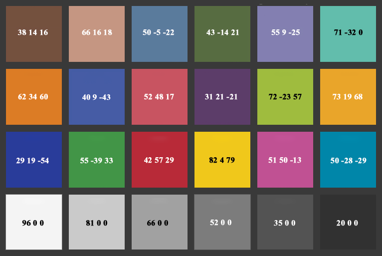

I usually just pin the contrast curve manually, using the gray patches to get the numbers close - and then adjust individual colors visually.
Each patch has standardized Lab values. These can be translated into any other color space - or Lightroom %.
