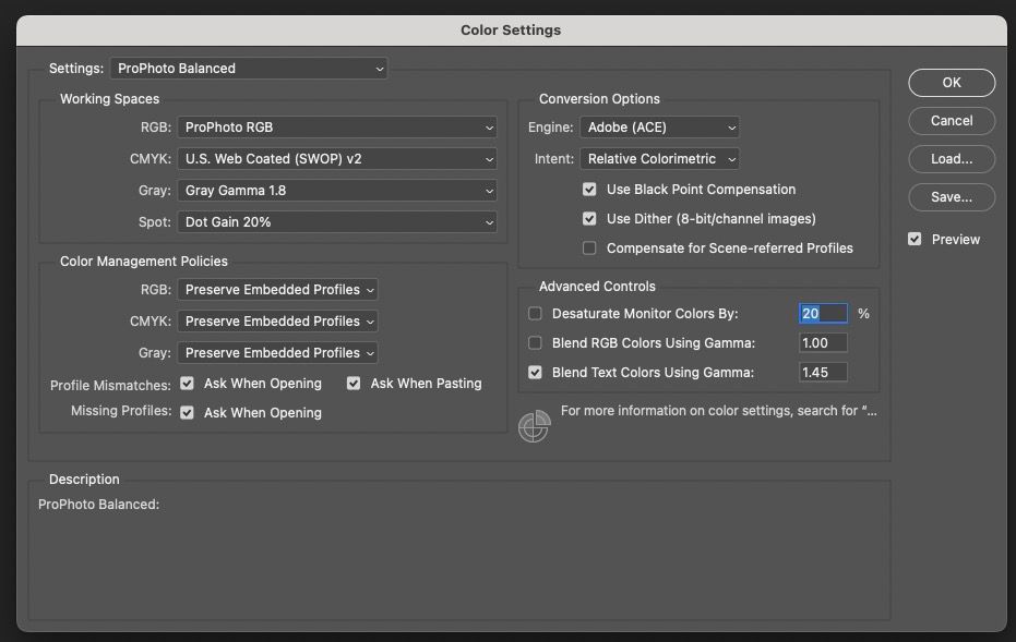

Why would you tag a jpeg with ARGB?
Jpegs should always be sRGB, because the sRGB gamma curve is better suited to an 8 bit image for general viewing.
The ARGB colour space is irrelevant in todays photo workflow, and really should be ignored.
Colour spaces in Lightroom are FIXED at Linear ProPhoto in the background, and Melissa RGB in the front GUI. You can NOT change them.
Only exports from LrC/ACR can be changed to a smaller colour space.
So, in LrC/ACR you ARE working in ProPhoto.  If you move an image over to Ps from LrC, Ps needs to be set to ProPhoto as the working space, but you need to switch the Grey Gamma to 1.8 an set that as the default.
Working this way, if you save the image in Ps, it looks the same when you view it in LrC, because it's in the LrC working space.
Once you finish the image processing, simply export it as a jpeg, converting to sRGB as the output space, and the ACE colour engine will do the conversion for you.  The result will be a jpeg in sRGB that looks the same as it did in LrC or Ps.
Just forget about ARGB as a working space.  As a measure of calbrated monitor colour space it's fine, but you monitor profile has nothing to do with Adobe Internal CM - unless you are softproofing for print.
Sep 26, 2025 Sep 26, 2025
quote
By @Wildlife_in_Pixels
No, this is patently wrong. Internally, Lightroom uses a custom color space with PP primaries and a linear tone curve. This is not the same as ProPhoto RGB.
It has no relevance for output from LrC. You can send from Lightroom to Photoshop in any color space you like, ProPhoto, sRGB, whatever, and it will be correctly treated in Photoshop because it is a color managed application. There is no particular need to use ProPhoto, and Photoshop certainly doesn't need to be set to ProPhoto as working space. This is a common misunderstanding. An embedded color profile, which it has out of LrC, will override the working space.
The "edit in Photoshop" color space is set in Lightroom Classic Preferences. Again, it does not need to be ProPhoto.

Explorer ,
Try reading: The front GUI of Lightroom uses Melissa RGB; which, for clarification, is ProPhoto colour numbers plotted against the sRGB tone curve!  WHICH IS NOT LINEAR...
The point was that you don't need to "edit in Photoshop" as ProPhoto, and you don't need to have ProPhoto as working space in Photoshop. These are both color managed applications, which means that any color space will be correctly treated.
The technicalities of Lightroom Classic's internal color spaces don't really matter in this context. Internally it's ProPhoto primaries with a linear tone curve; in the histogram and sliders it's ProPhoto primaries and sRGB tone curve. But none of that matters for output from Lightroom Classic.
On output, Lightoom encodes into a standard RGB color space of your choice.
