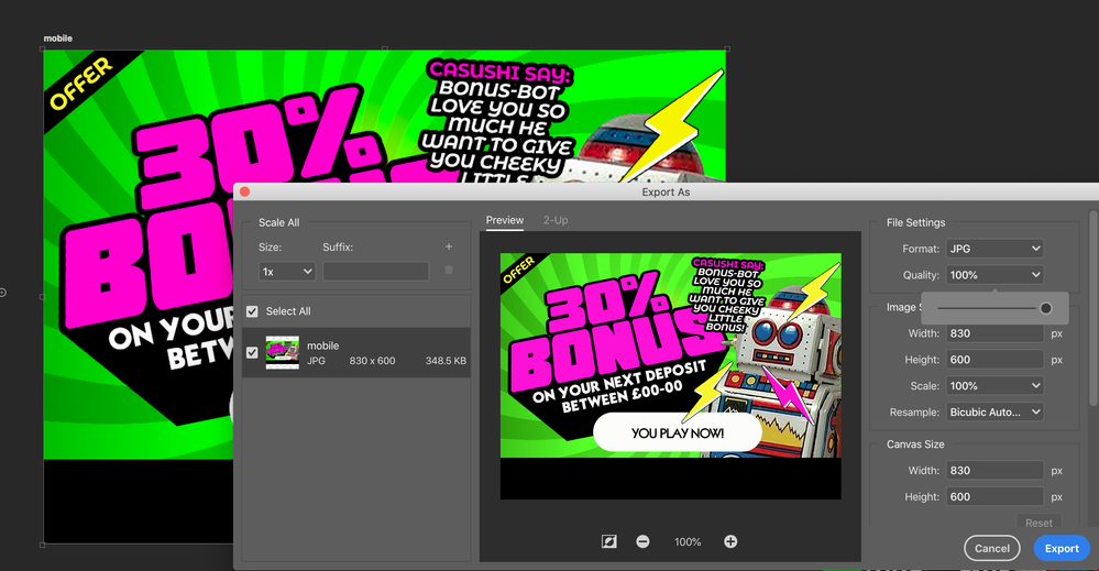

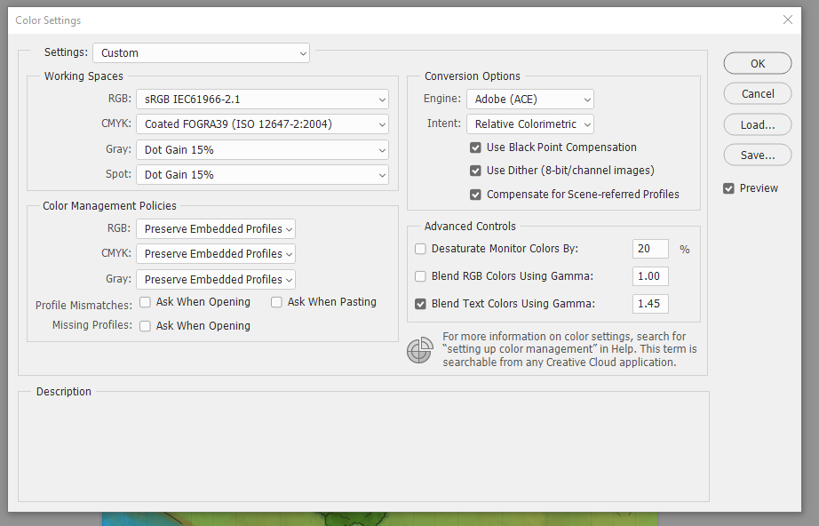

I have a photoshop issue. The colour in my RGB files are really bright and vibrant and when I 'save as' the colours remain good. But if I 'export as' the colours get dulled down and washed out as if the file was desaturated or converted to CMYK

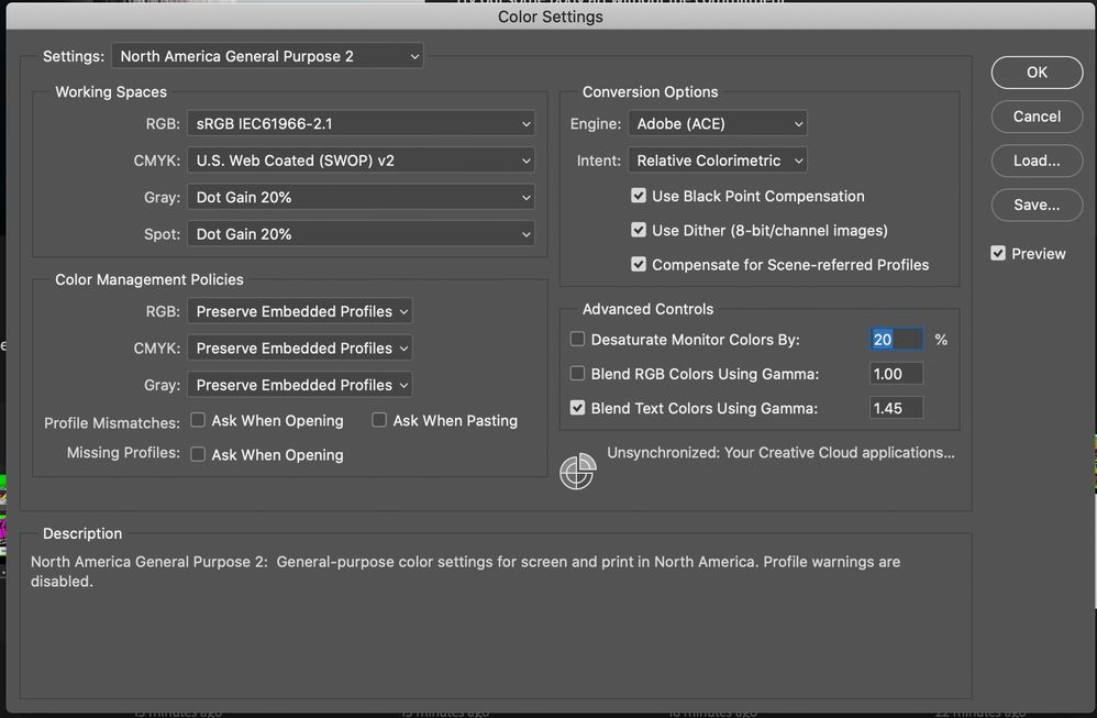

You said
"I don't have those options on export"
Yes you do - scroll down and you will see them in Export As
Your screenshots show that you are using untagged images and images tagged with the monitor profile.
In colour settings check "Ask When Opening" for missing profiles. When downloading images from the web then decent tesst images should be tagged with the correct profile. If they are not, and you get the warning due to that box being checked, then it is a fairly safe bet to assign the sRGB profile to it (not the moniotor profile).
It seems that you may need to learn a little about colour management and what the various profiles are for.

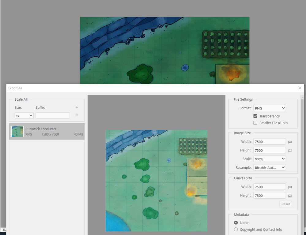

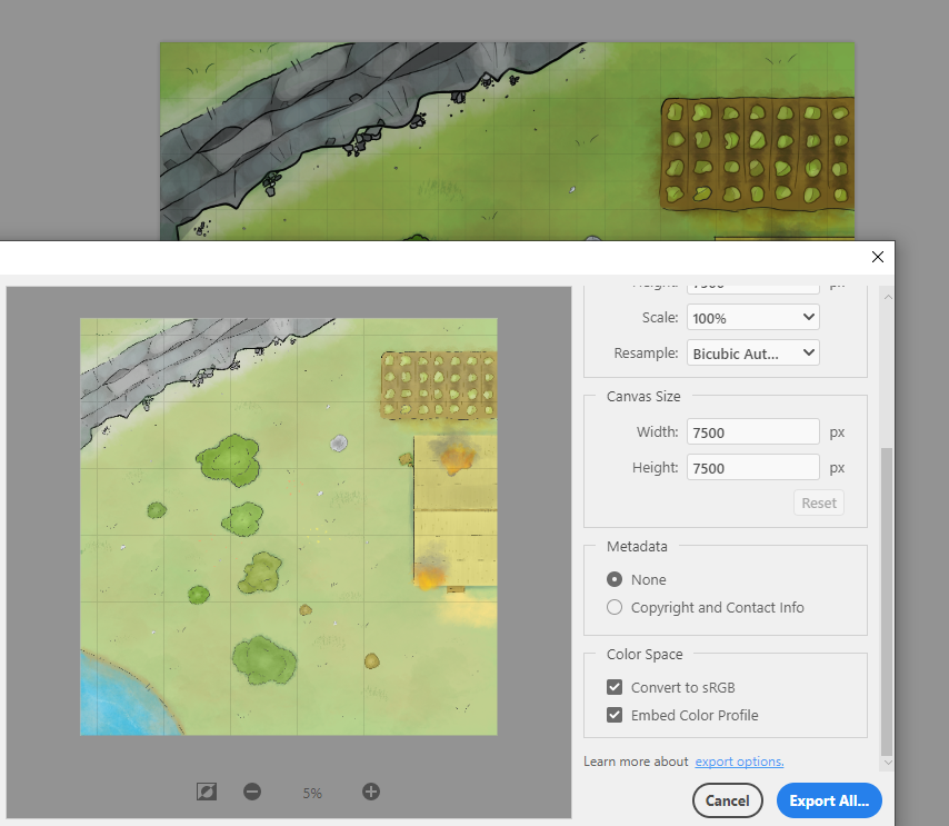

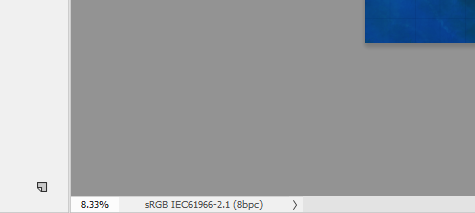

I seem to be having the same issue as the OP. But after testing all of the above, I don't get any difference.
My colour profiles match. I have tried enabling Legacy Compositing, flatten image before export etc.
This is all done inside Photoshop. No Windows Photo or anything was used. I have also tried all outcomes of using "Convert to sRGB" and "Embed Color Profile".
Hopefully, you can see on the attached images.

Apr 09, 2020 Apr 09, 2020
Hi
so you are working in sRGB, so you start with an sRGB image - right?
1: you 'save as' with the profile embedded (always embed the profile BTW) and re-open in Photoshop - it matches the original, great
2: you export with sRGB embedded and reopen in Photoshop - and the colour is desaturated?
is that right?

Again: Convert to sRGB and embed the profile. Done. That's it.
If you are viewing in an application without color management, it will be off in any case. Nothing to be done about that; if there is no color management, then there isn't. That's not a Photoshop problem. That's a shortcoming in that other application.
But sRGB has the highest likelihood of being roughly ballpark in most scenarios, even without color management. That's no guarantee, just a likelihood.
Always use color managed applications to view your images. Web browsers, image viewers, anything.
