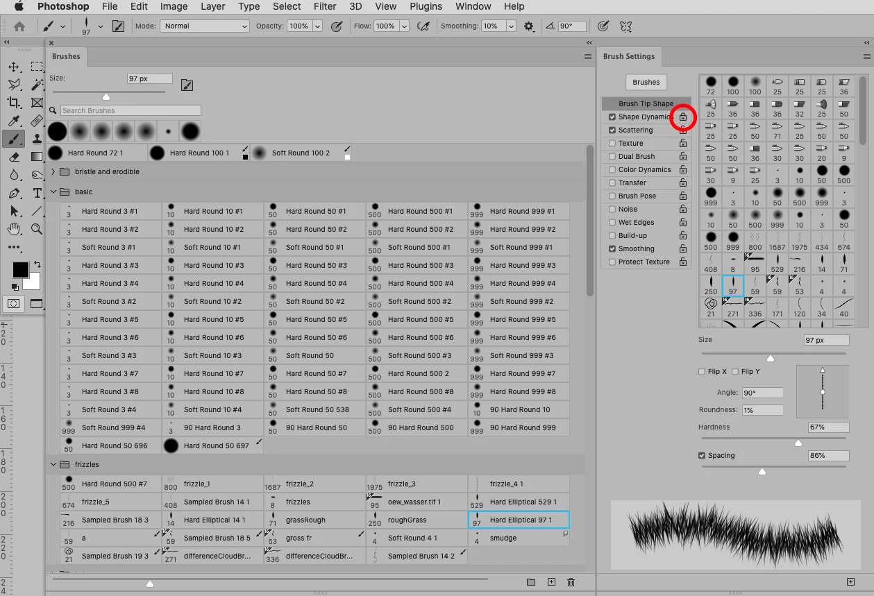

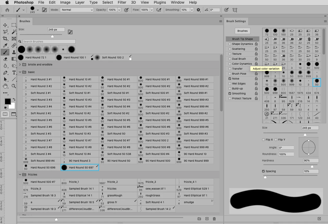

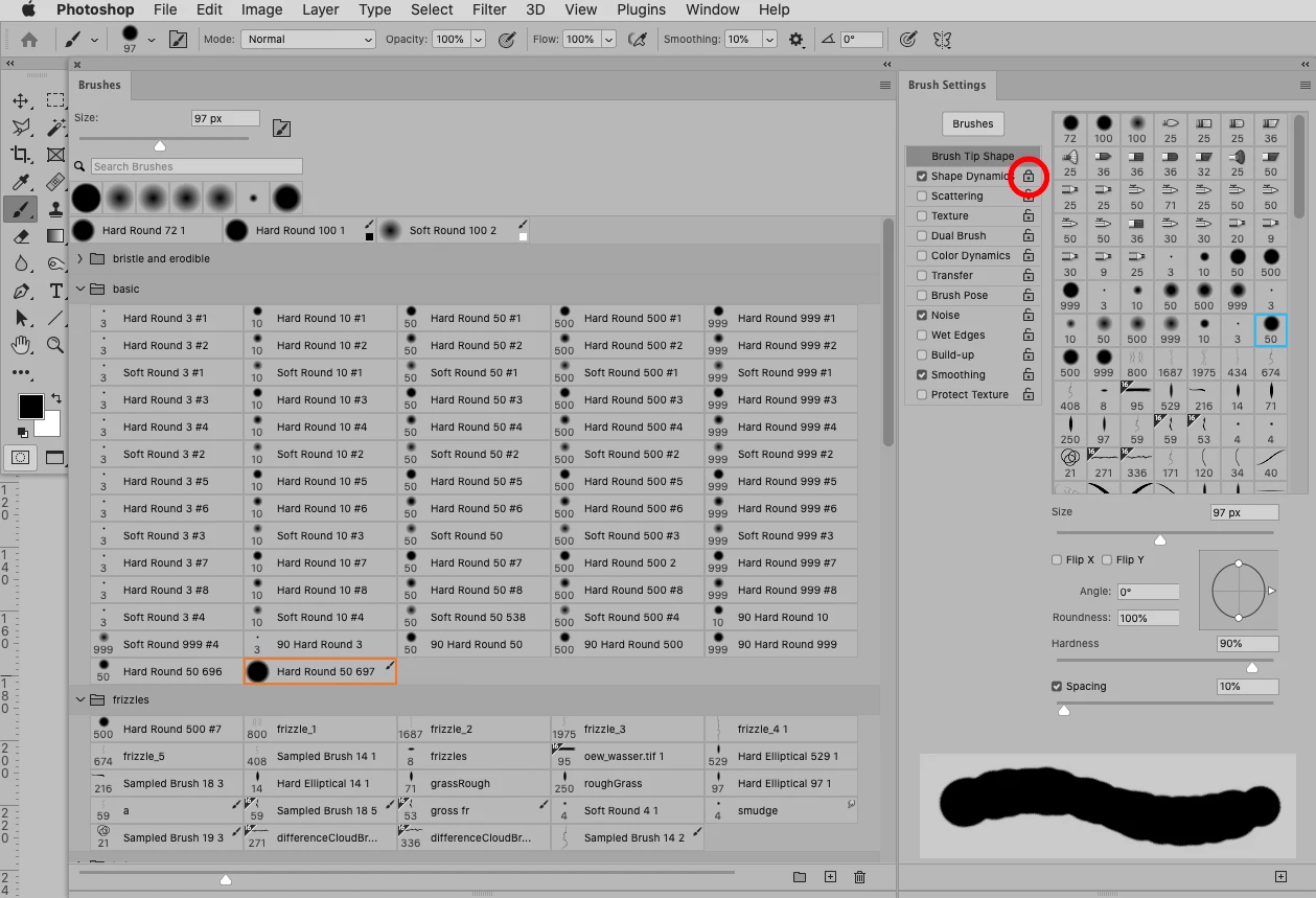

Correct answer c.pfaffenbichler
To clarify what »locking« is supposed to do some screenshots:
• a round brush without Shape Dynamics is selected
• a brush with Shape Dynamics is selected
• the Shape Dynamics are locked
• when selecting the Brush that doesn’t have Shape Dynamics again it assumes the locked Shape Dynamics – as documented and intended
