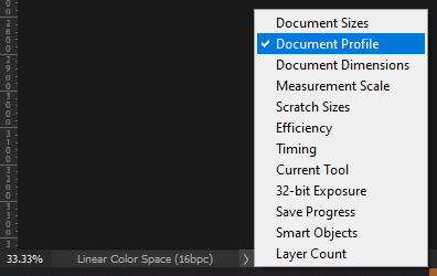

How can I tell if there is an embedded profile?
This is what the Document Profile currently displays:

That screen captures hows indeed, it's in a "Linear Color Space (16-bits") but that seems an odd name for such a profile.
DO NOT ASSIGN sRGB to this data, convert to sRGB. There should be no such color shift thereafter doing it this way.
Author “Color Management for Photographers" & "Photoshop CC Color Management/pluralsight"
Apr 11, 2023 Apr 11, 2023
OK, then try to convert to sRGB IEC61966-2.1.
If that linear profile is a valid icc-spec profile, that conversion should result in no visual change. It should then be remapped to the sRGB tone curve (and sRGB primaries).

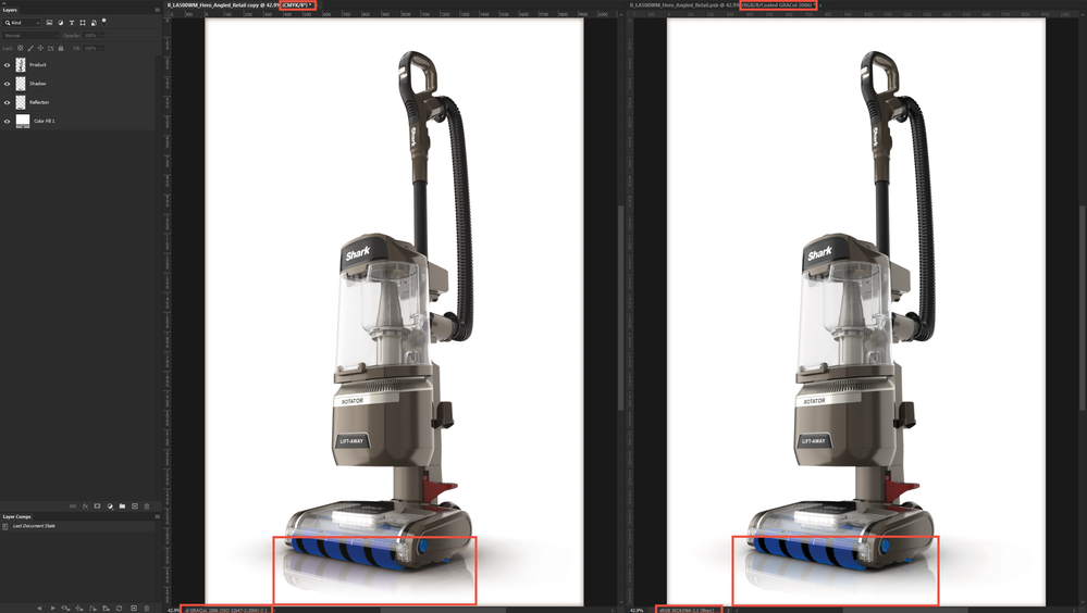

So I tried the SoftProofing and did a side-by-side comparison with a conversion to CMYK/Assign GRACol. Weirdly the SoftProofing does not show the color shift.
quote
By @seans94943058
On a copy, flatten first, then convert or convert with flatten on. This should then match the softproof.

You see no difference because according to the Proof Setup screen capture, the document is GRACol as is the soft proof.

Sorry DigitalDog, I'm confused, the image on the right is sRGB with the GRACol softproof applied. The image on the left is CMYK with the GRACol profile assigned

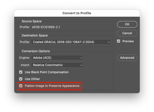

Here is the file in question:
Apr 12, 2023 Apr 12, 2023
quote
By @seans94943058
The file is OK, the problem is the conversion to CMYK while retaining the layers. Again, flatten during conversion or beforehand in a copy.
Why do you wish to have a CMYK file with layers? In this case, what benefit does it provide? The downside is obvious.
The RGB file should be considered the working file (layered), while the CMYK copy is a flattened derivative solely for output.
I am not saying that layered CMYK working files have no validity... Just trying to understand why you are converting without flattening.
