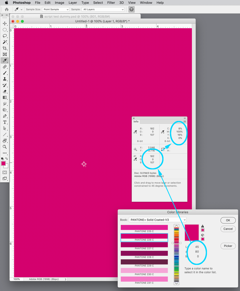

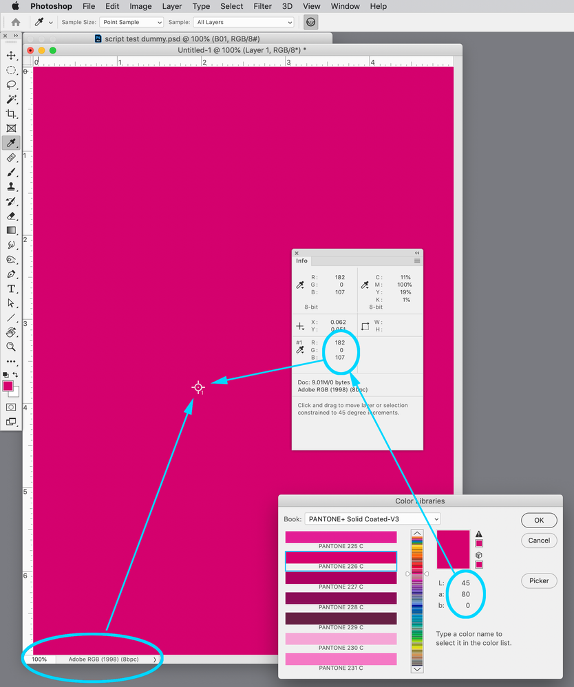

Hi @Rafael26281653wpvv , You didn’t mention your destination document’s color mode and profile assignment—is it RGB or CMYK?
If you are picking Pantone 226 from the Color Picker’s Pantone+ Solid Coated Library, the color is defined as Lab, and if you apply the color to an RGB document, the Pantone Lab values will be converted into the document’s assigned RGB space.
Here my document is RGB with AdobeRGB assigned, and the starting 40|80|0 Lab values get converted to RGB 182|0|107 when I apply it to the document. The Info Panel’s CMYK values are showing the  CMYK values I would get on a future conversion to the current Color Settings Working CMYK space (Coated GRACoL 2006 in this case), not the Actual Color:
If I change the Color Settings’ CMYK Space to US Sheetfed Coated you can see the assumed CMYK output values change from 11|100|19|1 to 8|100|16|0, but the RGB values are the same:
If you are editing in an RGB space the final CMYK output values will depend on where the file is going. Are you placing it in an InDesign page layout with its embedded profile? And then where is the final conversion to CMYK happening, and to what CMYK profile—on a PDF export or at print output?
