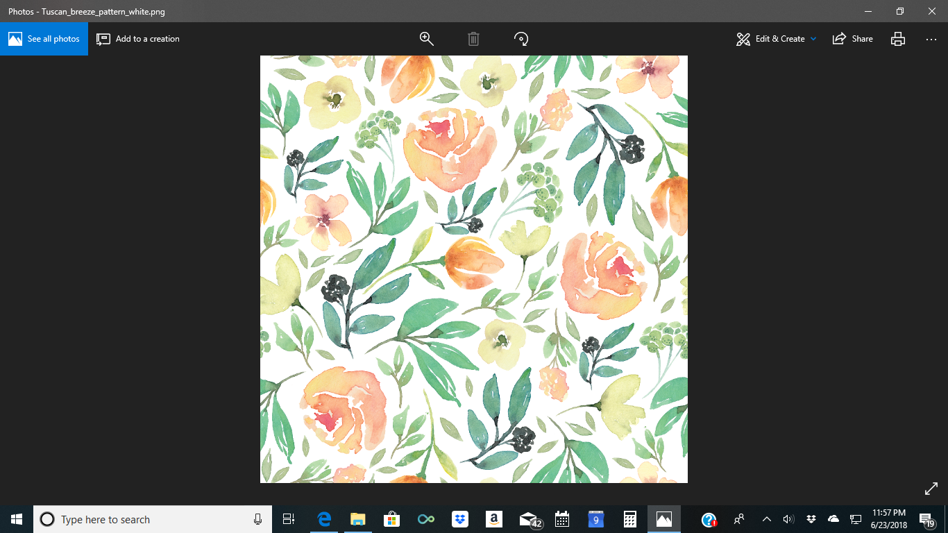

The above is a file of a multi color print that I purchased from a website that sells graphics/artwork. This was originally hand painted and I was only able to download it as a PNG file. The end use would be for textile printing. I would like to be able to recolor this print in a few different colorways (see examples below of other prints I have recolored in the past). Can this be accomplished with a PNG file? Thank you.

The image’s original file format is pretty much irrelevant.
Is it a regular 8bit RGB image?
How many colors of you want to print?
Your screenshots don’t seem particularly useful as they do not seem to convey relevant information and lack to display pertinent Panels.
The multicolor images seem to have gradients in some colors, are they multi-channel images with Spot Channels?

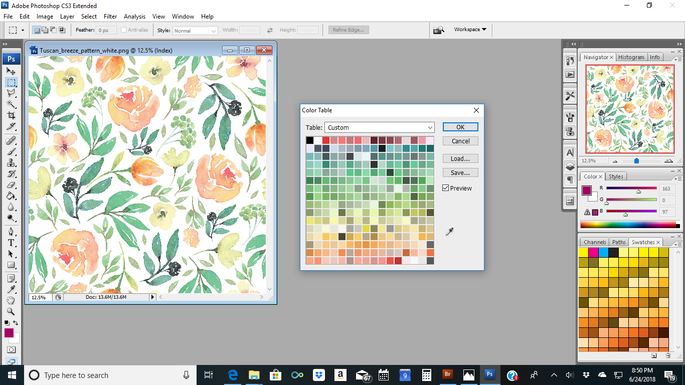

I believe it is a regular 8 bit RGB Image. The High-res 300dpi PNG file. Yes the multi color image has gradients (color shading/variations) throughout. In order to maintain the integrity of the print I feel I would need to narrow it down to at least 28-32 colors. That is all I know about this print. Regarding your query about "multi -channel images with spot channels" I'm afraid you have lost me there. In addition the "lack to display pertinent panels" again not clear what it is you are asking to see. I'm sorry I can't be of more help to your queries. I'll just play around with it and try to figure it out. Thanks for your help in any event, appreciate it.

In the images of existing print patterns there were 12 color fields at the bottom which I assume means they were printed with 12 colors.
So from a preprint point reducing the colors in your Indexed Color Table to ~30 would not be good enough.
Instead there would have to be 12 Spot Colors.
And so far Photoshop can handle Spot Colors only as Spot Channels.
But each Channel can have pixels of varying brightness, so gradients and modulation within each Channel is possible.
But this also leads to the question of trapping.
Who handles that so far?
