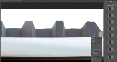

The screenshot below shows fringing (a green outline) around the top of the metal fence.  From what I've read online, this is also called Chromatic Aberration and is caused by the camera lens.  The fix to it in Photoshop directs going to Camera Raw Filter and following the steps pasted below the screenshot.  The problem is, Camera Raw Filter is grayed out for me (visible in screenshot).  Does anyone know why that might be?  Thanks.

Off the top of my head I don't know why the filter is disabled - but what strikes me here is that you have a bad selection to start with. This isn't chromatic aberration, this looks like residue from the original background. Running defringe on this would just result in a dark "inverse halo" outline. I'd clean up the edge, and then the green will disappear.

Thanks.  But in the screenshot below, you can see the layer on which the selection was based (the selection layer above it is turned off), and it's apparent the fringing is in that layer too.  The selection was made by using the lasso tool to select from underneath the fence (on the aluminum frame) to the top edge of the file, and then Select Color Range to select just the fence, in order to lighten it only.  So in other words, the fence (using for example the Quick Selection Tool) was not the basis of the selection.  Do you still think it's the selection?  And does that affect how I resolve the issue?

I see from your screenshot that the image is more than 82,000 pixels horizontally.
If you use the keyboard shortcut (Shift+Ctrl+A) to launch the Camera Raw filter, you should get this message:

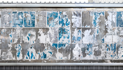

Nov 02, 2023 Nov 02, 2023
