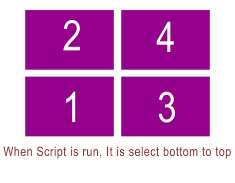

Participant ,
Sep 09, 2021 Sep 09, 2021
I am trying lots of time but didnot work..
return l2 - l1;
Position is good but It's right to left
I want left to right

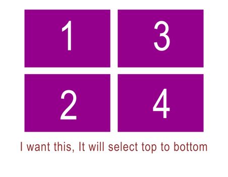

For Better Understand I have posted the image

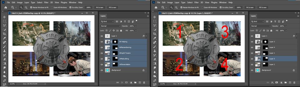

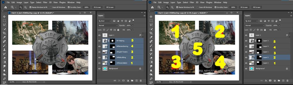

We do not know how you expect this script to work. Right now the script sorts the layer bounds and renames the layers by their bounds order bottom left  to top right.
My collage populating script populated this five images  collage in the following order Top Left image, Top Right image, Bottom Left image,  Bottom Right image, Center center image.  You can see the layer are 1,2,3,4,5 bottom of the stack to the top of the layer stack.  Your script rename the bottom left image layer 1, The top left image layer 2,  The Center center image Layer 3, the bottom right image layer 4 and the top right in layer 5.
That is what the script was programed to do.  If you want some other naming convention you need to design the process. The things is when layers overlap  the stacking position is as important then the bounds.  That is why my center center image is  topmost in the layer stack.
Your script has nothing I want. Who Programmed it for what?

Participant ,
Yes I have marked red please check it @JJMack
top to button only

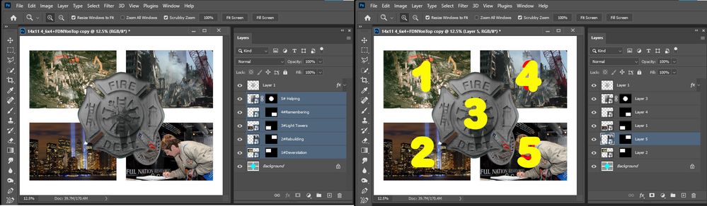

You do not seem to understand that the script is design to rename layer based on their position over the documents canvas.  If I change the Sorting routine and select only four of the five  image layers the layers may be renamed the way you want.  It depends on which Image layers I select. However if a Select all five image layers two  of the five will be renamed like you want the other three will not,  The script renamed the selected layers relative to their position  over the document canvas. The Five image would be renames like this.
The  order my script populated the Collage was like this.
Here populated with Image Name stamping  and text and Image layer style added using my scripts available options.
JJMack
Participant ,
Sep 10, 2021 Sep 10, 2021
Yes I want this top to bottom select layer @JJMack

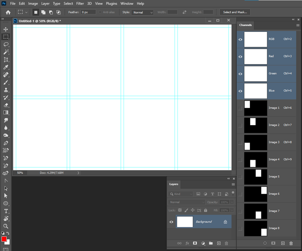

If you want that script to be modified to operate differently you should make the modification yourself.  If you want a template like you show in the order that you show and not do any Photoshop scripting.  You need to find a Collage populating script the its easy to create templates for that will be populated in the order you desire.   You just need to create a simple collage template.
My free Photoshop Photo Collage and Mockup Toolkit's  collage script would have no problem populating a template like you want.  You just need need to create the template psd/psdt  then point a collage populating script to the template and the folder your image are in. The image will be populated in File Name sort order into the collage template Image areas in the Image Area order you created in the template.  You control the Image  file processing order via file name and collage area by Image area alpha channel image numbers the  Image 1 to Image N.  N has a Photoshop limit of 53 alpha channes. So a collage template has a limit of 53 Images the cans be populated and the Image numbers need to be sequential 1,2,3,4,... there cans be no gaps if there  is no 3 only two image will be populated.

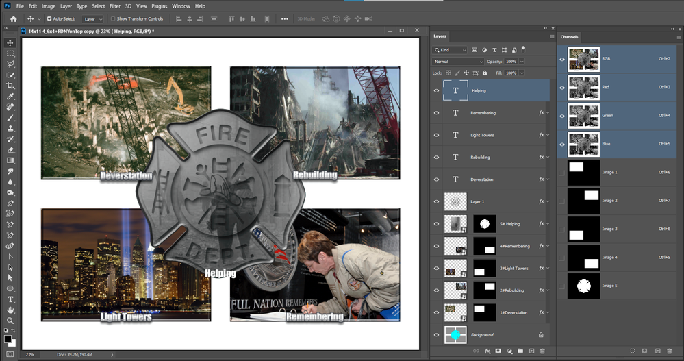

The template for your College would look like this:

May 05, 2021 May 05, 2021
Sure knock yourself out look at the script code in my script and modify that script with code in like my scripts have.  IMO you should read the help in my package to understand how my scripts work and learn all they can do.
Im my Package the followind scripts can be used to populate a collage template like you want.
  1. TestCollageTemplate.jsx - Used to test a Photo Collage Template while you are making it with Photoshop.
  2. InteractivePopulateCollage.jsx - Used to interactively populate Any Photo Collage template. Offers most user control inserting pictures and text.
  3. PopulateCollageTemplate.jsx - Used to Automatically populate a Photo Collage template and leave the populated copy open in Photoshop.
  4. BatchMultiImageCollage.jsx - Used to Automatically Batch Populate Any Photo Collage template with images in a source image folder. Easier to use than the interactive script. Saved collages can be tweaked.
