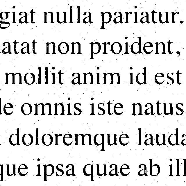

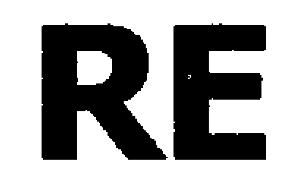

OK, have now had a chance to do some before and after comparisons and sadly, while the script is good, it is as I said in post 3 which is "not quite the same thing that I'm looking for".
With the before and after I've noticed that thin type is being "destroyed"
whereas other type and the little dots are being fixed nicely
but again, that's not quite what I was hoping the outcome would be. Again, I imagined that the script would look for any instance of black pixels with an area less than figure X and then invert them... It's hard for me to articulate so let me use this example:

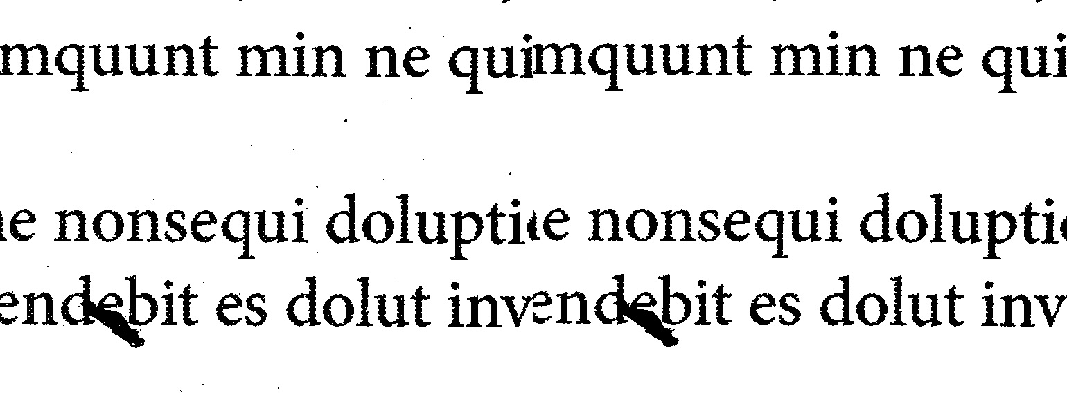

Here’s a screenshot of part of the image before and after.
You could give the Script a try if you want.

Contributor ,
Jan 14, 2013 Jan 14, 2013
I have created plugin for this
feel free to use it:
https://dl.dropbox.com/u/167681/ReprintMaster.plugin.zip
unfortunately filters don't work in lineart mode, so you'll have to convert image to Grayscale first. but my plugin is free unlike the one you mention in startpost, and works on mac - the one mentioned is windows only )
it shouldn't be a problem, just record action which converts to GS, calls my plugin and then converts back to lineart
If you need to work upon RGB/CMYK - you'll have to process each channel separately, I didn't code it yet.
Rough white/rough balck option will not account for diagonal pixel connections
before - after
https://dl.dropbox.com/u/167681/scan0329.png
here's a quick demo
https://dl.dropbox.com/u/167681/reprint_master_1.gif
https://dl.dropbox.com/u/167681/Screen-shot-2.gif
(plugin is 32bit only, going to update for CS6 soon)

Jan 15, 2013 Jan 15, 2013
no need to run in 2 phases with invert - white size does exactly that. i.e. set white to 10, and it will fill white holes with size <=10 with black.
well... it's not working in my case. to demonstrate, here is a sample of some white pinholes in the E to eliminate, along with black pinholes in the white.
and here is the result
I have also tried this with 10 and to no avail. Have I missed something?
Running Photoshop CS5.1 on Mac in 32bit mode
If the answer wasn't in my post, perhaps it might be on my blog at colecandoo!
Contributor ,
hm, could be some experimental build - I've started to improve defects on edges, but cancelled somewhere.
I have tried version I have installed on my production mac, and it works fine - here it goes
https://dl.dropbox.com/u/167681/ReprintMaster_production.plugin.zip
(original link is corrected as well)
