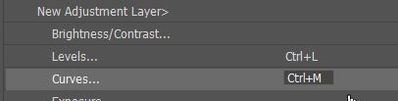

A hint- Modify your Keyboard shortcuts. [Alt+Shift+Ctrl+K]
eg.  Change the [Ctrl+L] shortcut to create a new Levels Adjustment Layer.
1) First remove the default [Ctrl+L] shortcut in 'Adjustments>':  (Select & delete)
2) Add the [Ctrl+L]  (simply press the shortcut keys) in 'New Adjustment Layer>'
I illustrate the same change for Curves [Ctrl+M]
