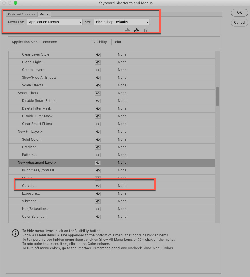

I don't know of a way to edit the Adjustment Layer list at the bottom of the Layers Panel, but they CAN be edited from the Layer menu. What's reallly important here is that you can ADD A KEYBOARD SHORTCUT to the Curves Adjustment Layer, so you can add it that way - no mousing. A
And, when you convert your image to the Lab Color Space (Image>Mode>LAB), your info panel should give you LAB options.
Screen Shot 2021-01-27 at 2.17.33 PM.pngScreen Shot 2021-01-27 at 2.21.04 PM.png
