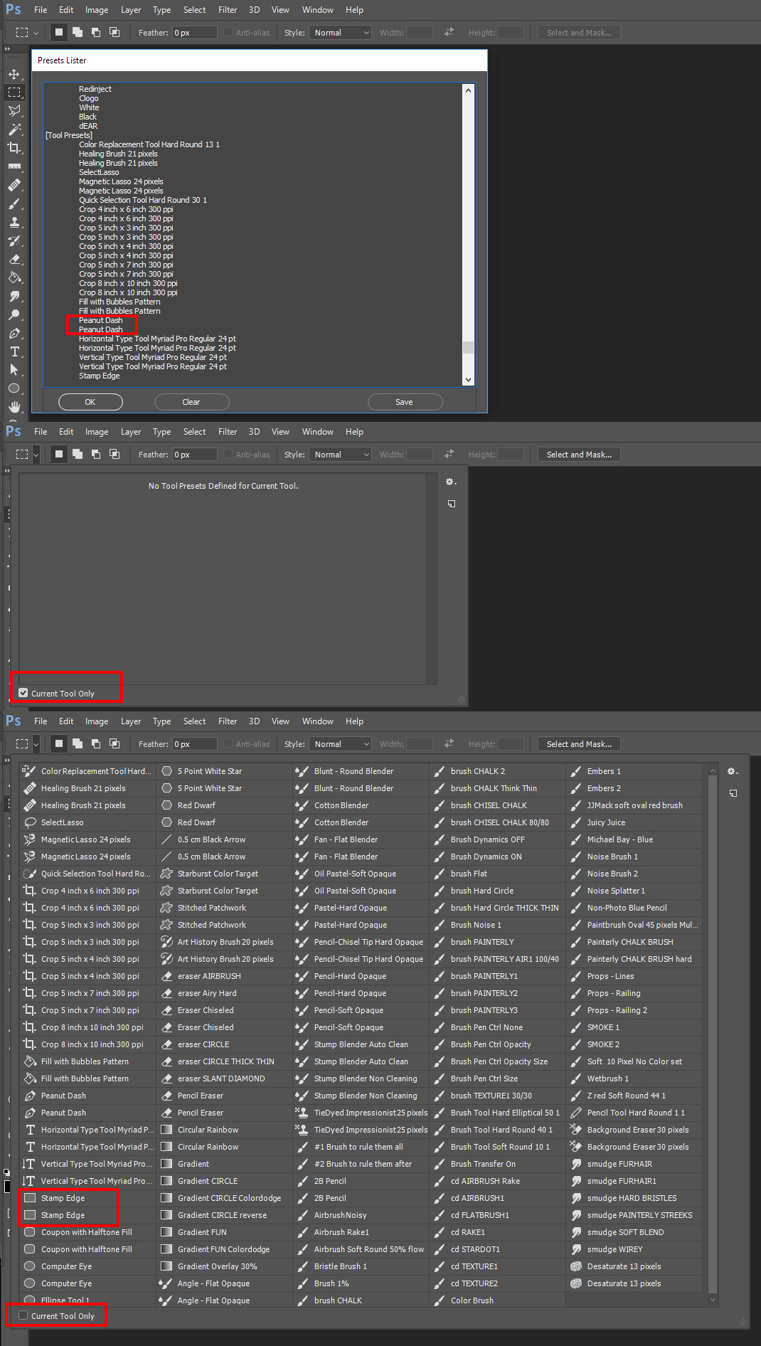

If you know the tool you want to cycle through it loaded presets you should be able to.  I qite sure I have seen a script posted here that retrieve tool loaded presets names  Try the search
https://forums.adobe.com/search.jspa?place=%2Fplaces%2F1383833&q=preset+list .
JJMack
marior90336416
January 13, 2017
Thanks JJMack, let's see if I got right what you mean. Let's say I have a set of smudge presets on the Tool presets. Let's say I have 3 types, Hard, medium, Soft. I can assign a hotkey, say, F6 to load a script that will cycle through them? Like, I select the Hard, press F6, the script load up and move to medium, F6 again, move to Soft. Press F6 again, go to Hard. Is it how it would work?

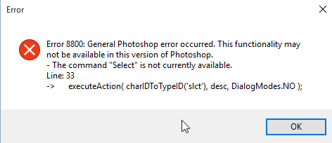

I haven't tested but I've found this thread
Re: Is it possible to cycle through brushes (tpls) using a script?
marior90336416
January 13, 2017
I tried the script on that post, put my brushes name there and got this message. Not the the line I've changed hehe.
