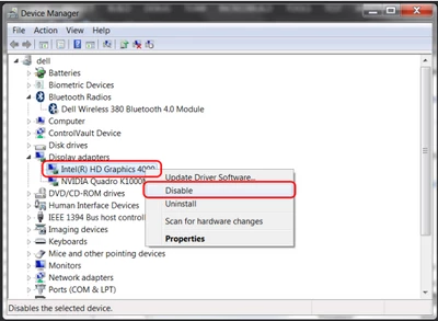

Correct answer AxelMatt
In the system info I see that there is a Intel UHD GPU CTIV: I think this is the CPU internal GPU. Please try to deactivate this GPU in device manager in Windows and check.
More informations you'll find here: https://helpx.adobe.com/photoshop/kb/troubleshoot-gpu-graphics-card.html

I disabled Intel UHD Graphics. The result was that my screens were suddenly arranged incorrectly and one of the screens was frozen. But after rebooting, everything runs perfectly now!
Thanks to all helpers and especially to Axel Matt who found the solution.

AxelMattCommunity ExpertCorrect answer
July 18, 2023

@Artnika
It may help if we could see your Photoshop System Info. Launch Photoshop, and select Help >System Info...and copy/paste the text in a reply.
ArtnikaAuthor
July 17, 2023
I downloaded and installed the latest studio version (536.40-notebook-win10-win11-64bit-international-nsd-dch-whql.exe), then I rebooted my computer, but it's still the same problem. I get the same error message.
AxelMatt
July 17, 2023
Please check that you have installed the latest version of the device criver for the graphic card. If not download the latest version, install and check again.
Please notice: you should use the "Studio Version" and not the "Game Ready" version of the graphic driver!!
