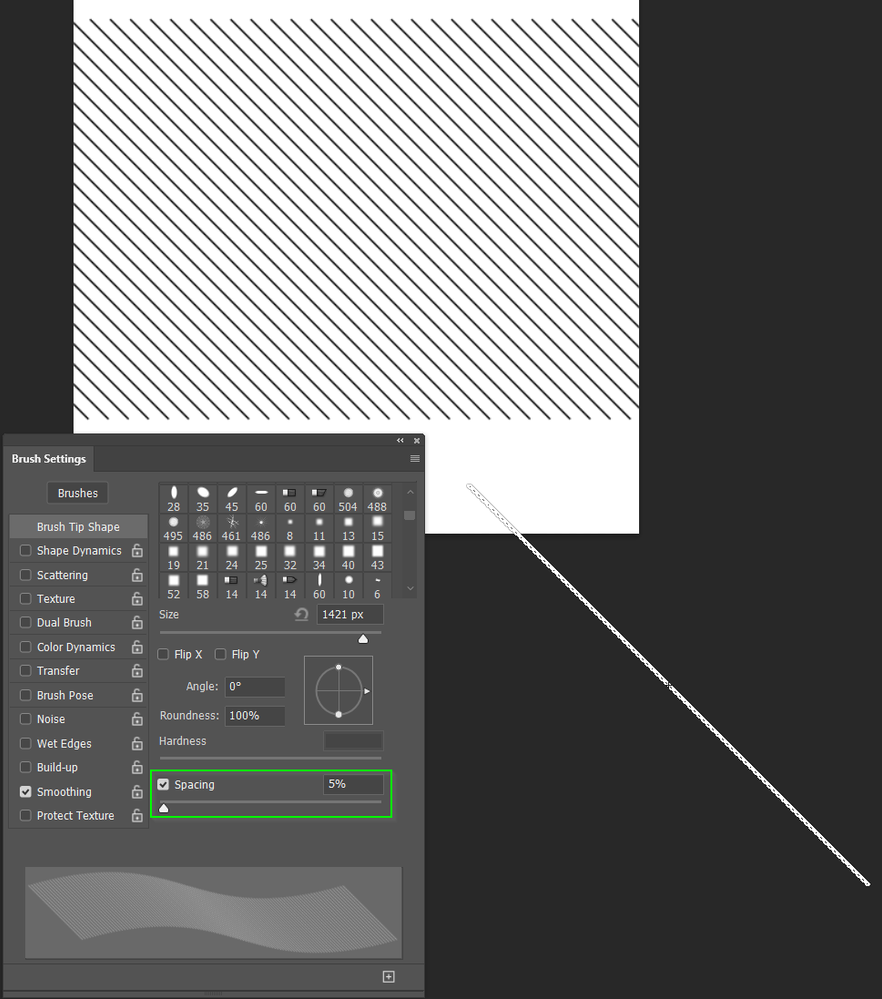

If you draw a straight line by holding down the Shift key, and used Free Transform to rotate it 45° (or your angle of choice) you could then define it as a Brush Preset (Edit > Define Brush preset).  You could then daw a cross hatch pattern by adjusting the brush spacing.
This is with spacing set to 5%
If you crop the cross hatch above with a perfect square (holding down shift again) you can define it as a pattern.
It's important that one of the diagonal lines is exactly at the corners wh
It's important that one of the diagonal lines is exactly at the corners when cropping.
It's difficult to do this with crop tool directly, but if you drag out a rectangular selection, it is much easier to be more accurate.  With that selection in place, go Image > Crop and it will crop to the selection
Go Edit > Define Pattern and you can use this going forward.
BTW you can test your pattern before defining it by using View > Pattern Preview.
