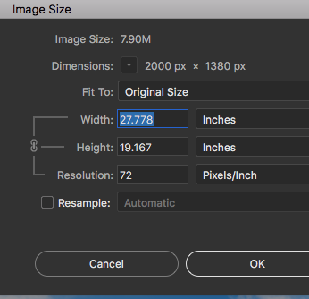

Hi, I'd like to know the difference between DPI and pixel size, and how it can affect the quality of the image I upload on social media (Facebook, twitter, etc). As far as I know, DPI is for printing. Pixel size is for computer image itself. If I upload a Facebook cover page which is (820 x 461px. DPI is 72) but the problem is the picture is somehow pixelated. Now one suggested that it should be 300 dpi to ensure that its clear and high resolution. Would anyone, disagree because it should stay 72 DPI and the pixel size should be the one to adjust.
My question is:
Is there any difference between adjusting the DPI or pixel size? They said its different.

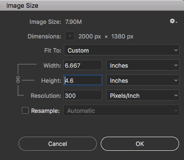

Correct. Only the print (document) size changes, not the pixel dimensions.

An image DPI setting is a Prints Pixel size.  An Images DPI setting is meaningless when it come to displays. Displays can not change the size of the Pixels they display that have a single pixel density.  Printers can print pixels any size up to their max print resolution.   For example inkjet printers use many smaller droplets of ink to paint in your images larger pixels.

If resample is checked, then increasing the ppi from 72 to 300 would blow the pixel dimensions up 4X which would blur the picture because it's making up detail. Not a good idea.

But, correct, ppi is Print metadata for paper, monitors display pixels.

If resample is not checked, there's no difference between 72 and 300 dpi right?
January 22, 2018
No difference to Facebook, which reads and recompresses all images, sometimes quite harshly with poor results. Don’t try to optimise the image compression, in fact my instincts are that best results will come from PNG.
