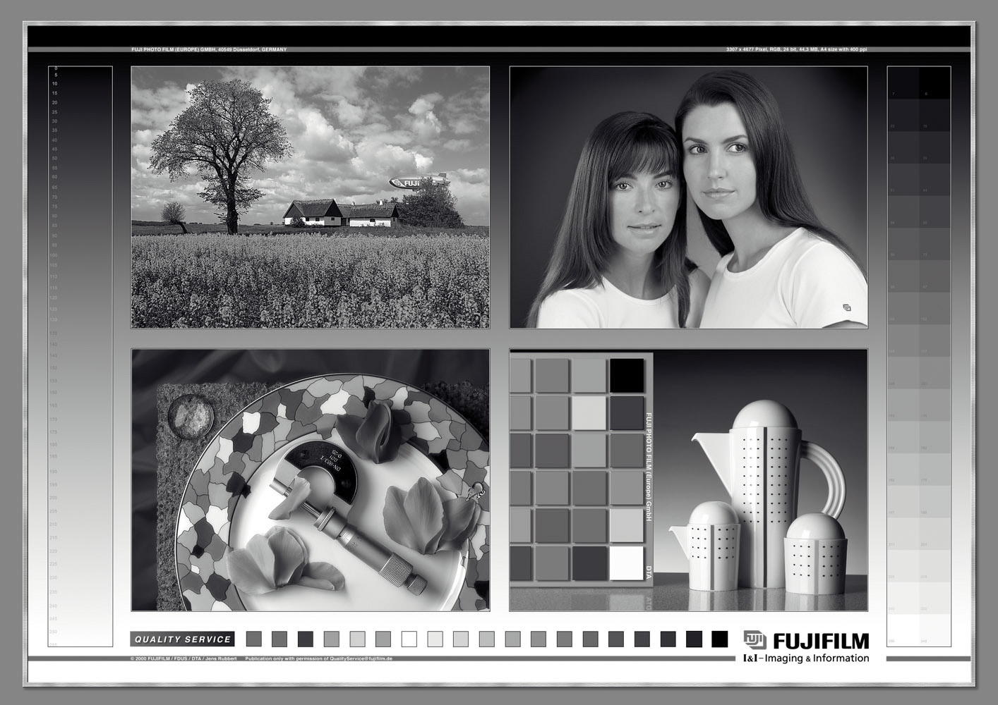

I've just started to use new profiles from my print company.  With their previous profiles I'd noticed little or no difference between Relative Colorimetric and Perceptual rendering intents when converting.  However, with the new profiles I notice a significant difference, even when the source image colours are well within gamut.  So I tested with a B&W mono image and it's the same there.  Why is this?  Is it because of the different way they adjust white points?  Do your B&W images change with rendering intent?

    That's what I thought, which is why I tried with a black & white monochrome image.  Surely there should be nothing in a B&W image that goes anywhere the printer gamut boundary?  I understood rendering intent was just about handling out of gamut colours, but it appears there must be more to it.

    And of course, a monochrome image should not show any differences at all. I think that suggests a broken profile - unless you see the same thing with all your print profiles.
