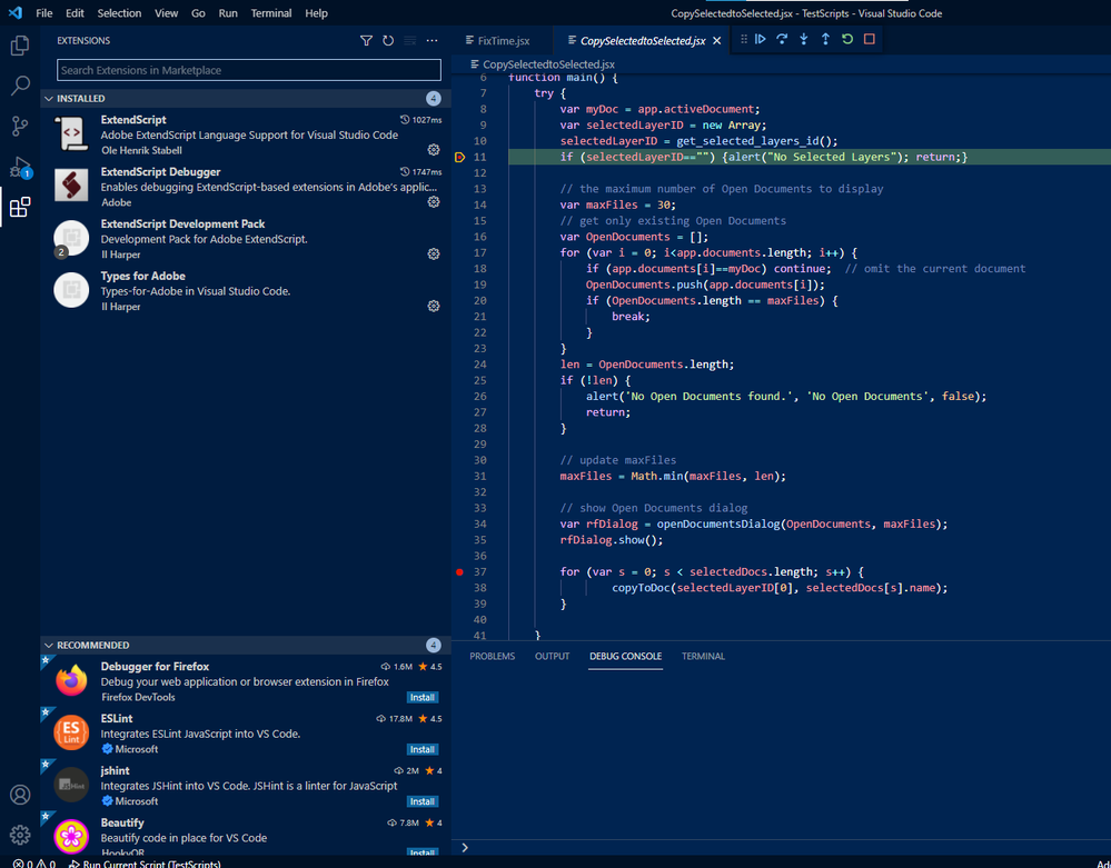

Hi Adobe Community,
Finally with some time on my hands, I'm trying to sink my head into using JSX with Photoshop and my install for ExtendScript fails. I come to find Adobe doesn't support ExtendScript any longer. So can I run VS Code's Package extension without it? As it seem like my only option besides Notepad.
Also, is there any easy install tutorials involving Photoshop out there? I can't seem to find any that aren't really involved. If possible just want to know how to use VS Code to get Photoshop to alert "Hello World", from there I can run tests, but I can't seem to just get setup without errors etc.

Extendscript is I believe all 32Bit code therefore will not be supported on a newer Mac.   When you run a Photoshop you do not use Extebscript or VS Code.   Scripts are more computer programs source code then they are programs.  Scripts are text files you do not need ExtendScript or VS Code to develop Photoshop  Scripts.  You just need a text editor.   I do not user a MAC
Both ExtendScript and VS Code have built is text editors they are sensitive to  scripting languages syntax like VSB and JavaScript.    While I have ExtendScript and VS Code installed on My Windows PC  I do not use either of them to develop and test Photoshop Script.    I never got VS Code and the Extentscript add onns working correctly on my PC and I dislike ExtendScript.  For I'm Dyslexic and when I use  extendscript UI  to develop and test Photoshop scripts there are too many windows where things are changing all the times, they are more a distraction then helpful. and I have also encountered problems in Extendscript implmentation where the problem  I had was in extendScript not my script.

...It introduces ScriptListener like JJMack mentioned above, but doesn't step you through getting started. I'm on a Mac which I understand leaves me handicapped in attaining ExtendScript at all. So I'm left with the VS Code environment which is actually pretty nice for a novice like me.
One thing that I ran into which was frustrating was the launch.json / hello.jsx wouldn't load in the app even open. It would just stall during run/debug. I found in my extensions that I also installed ExtendScript itself along with the ExtendScript Debugger extension. I uninstalled ExtendScript and I think that fixed the problem. I still have to make the application (PSD, AE, etc.) active in focus in order for the script to run, but it works.

I run Windows I can and have both ExtendScript and VS Code with the Extendscript Extension installed  and usable.
I never liked ExtendScript UI. All I use  in it is its Object Viewer. And I had issues in Extendscript when I did used it to debug with with some scripts.
I can set brake points and run Photoshop script via VS Code UI. However,  I do not know how to use all the features VS code has or know its UI or how all of it fits together.  I do not know much about json which seems to be used within the VS Code environment.  So I do not use VS Code to run and debug Photoshop scripts.

About VS Code if you have a complex project I'm sure you will find it very useful   Being able to set break points, watch list call stack  to step through your script is great and it running feedback is very helpful.  I'm just lazy I do not want to learn how to use it well.  It a bit awkward to use when I do not know its UI and debugging environment.  I look at it from time to time it may grow on me.
